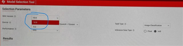

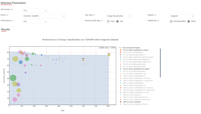

    In the meanwhile, I have used the Model Selection tool in Edge AI Studio to dive deeper into the benchmark results of TI.
    First observation, there is no data on the OD-2000 model, which is weird because it is explicitly used for advertising the SoC performance in the application notes.
    Second observation, for the Image Classification, the listed performance for CL-0160 seems very excessive in the TDA4VM chart. 807 fps versus the 162 fps in the application notes. See the screenshot below with the 0160 data point. So, this data point seems unusable for comparison.
    Third observation, the CL-0000 model shows 598 fps, which is 19% less than the 741 fps in the application notes. I am seeing a similar result in the TDA4VH data set in the Model Selection tool, i.e., 567 vs 741 fps.
    Based on the only usable data point for comparison, CL-0000, my conclusion would therefore be that the application notes are overly optimistic, roughly overestimating the performance with 20%. Nevertheless, it would still be very useful to know where the additional performance gap with the TIDL Runner benchmark originates from.
    Kind regards,
    Christophe
    I tried estimating model performance using https://github.com/TexasInstruments/edgeai-tidl-tools/blob/11_02_04_00/runtimes/examples/python/basic_example/basic_example.py, this script also provides time estimates.
    I got approximately cl-0160(164 fps), od-2000(130 fps), cl-0000 (556 fps). For me, cl-0160 is giving performance similar to application note but od-2000 and cl-0000 is degraded. But i wonder that you got 260 fps for od-2000, did you do anything different? can you share your compilation parameters or artifacts ?
    About the edgeai-studio,
    1. od-2000 do have a mention in 10.1 sdk in tda4vm with 317 fps which i am not sure right now how to get/measure 317 fps
    2. cl-0160 in 10.1 is mentioned around 160 fps which is similar to ours (but different from application note) whereas 10.0 mentioned 807 fps which looks suspicious
    3. cl-0000 is 600 fps in both 10.1 and 10.2 which is similar to ours but different from application note.
    I will further discuss with team internally about method used to estimate fps.

    As for Edge AI Studio, I only have access to the SDK 9.2 and 10.0 data sets in the Model Selection GUI, unfortunately. Do I need to do something special to get access to the 10.1 or 10.2 data sets?

  • Hi Christophe,
    Ok, thank you. I will investigate later this week with the basic_example.py and TIDLRT.
    As for the Edge AI Studio, I can only select from the 9.2 and 10.0 data sets. Maybe as a TI employee that you have more data sets available. Anyhow, I am going to focus on the real-life performance instead.
    Christophe
    Sure, you might be correct regarding 10.1 dataset.
