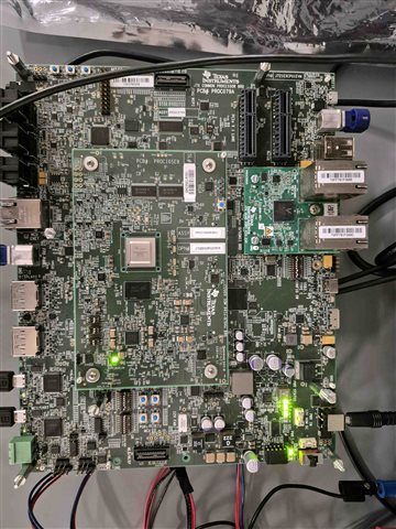

  • Hi Keerthy,
    I already started the same test on the EVM. I will let you know whether the same issue occurred on EVM or not next Monday. The probability is very low, like 0.06% over 40 hours test.
    The test we were doing is 40 hour power cycle test such as:
    1. Turn on power and wait for 2 seconds
    2. Capture serial console output
    3. In a minute, if we see login prompt in the serial console output, it's a success, otherwise, it's a failure
    4. Turn off power and wait for 5 seconds
    5. Repeat the above test for 40 hours.
    Test results on custom board are:
    1. Total failure count: 10 out of 3630 cycles
    2. No serial console output failure: 8 (I think it's not SDK related).
    3. Kernel panic failure: 2 (reported in this ticket)
    The test results on EVM so far (2 hours only) are:
    1. Total failure count: 3 out of 245 cycles
    2. No serial console output failure: 3
    3. Kernel panic failure: 0
    While we are waiting for the complete results on EVM, can you check the last portion of the log I shared and see if you can pin point to which module or software caused kernel panic?
    Charles

  • Hi Keerthy,
    The same issue has been observed once on EVM so far. Please check out the attached log file - cycle_547_uart.log.
    Charles

  • Hi Charles,
    Thanks for checking on the EVM. We will try this next week.
    - Keerthy
  • Hi Charles,
    Thank you for sharing the EVM logs.
    J7200 SDK version is v10.0, I believe.
    Also, I believe, the above methodology is how you replicated this issue on TI EVM,right?
    Additionally, can you share if you have made any changes in code with respect to the SDK used on the EVM as well as the firmware being run on the other cores.
    Additionally, can you also enable the system firmware logs using the steps mentioned in the below FAQ, as we are suspecting firewall exception to be a suspected reason for this failure.
    e2e.ti.com/.../faq-system-firmware-calls-have-failed-or-crashed-what-do-i-do
    Best Regards
    Gokul Praveen
  • Hi Gokul,
    Thanks for your reply.
    Yes. Same steps were used on TI EVM.
    No, just download the image and write it into SD card.
    Just back to office, will try and share the log once I have it.
    Charles
  • Hi Gokul,
    As mentioned in the link you provided: " 1. Trace configuration At system boot, traces are enabled for all subsystem sources on all destination transports." I connected microUSB cable to J43 and after cycle power, there's no message coming out of either UART ports. My UART settings are: baud rate 115200, 8 data bits, 1 stop bit, no parity, no xon/xoff.
    Charles
  • Yes, I tried both. None of them has output messages at all.
  • Hi Charles,
    Allow us some time to reproduce this on EVM at our end as well,
    Since the stack trace can look similar on Linux ,but reason for those can be quite different from custom board to EVM. We still would like to debug further on custom board as well.
    To enable the TIFS traces apart from board config changes have we made changes to enable the wakeup UART as well? Can you share complete steps.
    Also, TIFS does dump the traces in memory buffer as well , You can see if you are getting any traces their after connecting via jtag and dumping the memory
    Ref:Trace Layer — TISCI User Guide
    Diwakar
  • Hi Diwakar,
    Thanks for your update.
    I didn't make any changes to the image running on EVM. I just used the downloaded image from TI. Based on the link Gokul provided above, by default, WKUP UART should spit out trace message which I didn't see them on neither MCU UART ports. I don't know how to make changes because I didn't find much modification instruction from the link Gokul provided.
    I will give a try and share the info once I have it.
    I have done a 90-hour power cycle test on EVM and here's a list of files I zipped and uploaded for your reference:
    EVM2.zip
    power_cycle_test_evm.sh - the script for this 90-hour test. We use BK 1687B power supply.
    main.log - the above script's output
    summary_33_failed_cycles.txt - a summary of preliminary analysis of all failed cycles
    cycle_xxxx_uart.log - Linux console output log for cycle xxxx
    Charles
  • Hi Diwakar,
    I started another EVM test and it caused kernel panic at power cycle 214. However, I couldn't connect debugger to either A72 cores. Please see the console log and debugger screenshot in the attached zip file. I have no problem connecting debugger to a normal operation custom board and read the memory region you mentioned.
    EVM3.zip
    Charles
  • Hi Charles,
    In order to enable the TIFS traces, we need to do following changes.
    /board-cfg_j7200.yaml arch/arm/dts/k3-j7200-r5-common-proc-board.dts
    diff --git a/arch/arm/dts/k3-j7200-r5-common-proc-board.dts b/arch/arm/dts/k3-j7200-r5-common-proc-board.dts
    index b9f62cb7..7ac54bbd 100644
    --- a/arch/arm/dts/k3-j7200-r5-common-proc-board.dts
    +++ b/arch/arm/dts/k3-j7200-r5-common-proc-board.dts
    @@ -119,3 +119,8 @@
    +&wkup_uart0 {
    +   status = "okay";
    diff --git a/board/ti/j721e/board-cfg_j7200.yaml b/board/ti/j721e/board-cfg_j7200.yaml
    index a1e55a26..1afeea91 100644
    --- a/board/ti/j721e/board-cfg_j7200.yaml
    +++ b/board/ti/j721e/board-cfg_j7200.yaml
    @@ -32,5 +32,5 @@ board-cfg:
                     subhdr:
                             magic: 0x020C
    -                trace_dst_enables: 0x00
    -                trace_src_enables: 0x00
    +                trace_dst_enables: 0x01
    +                trace_src_enables: 0x3F
    The rebuild UBOOT using "make uboot" command and copy the images to the boot partition of the SD card. We will get the traces on the Wakeup uart.
    I am going to create similar test at my end , here are the steps which i will be following, do let me know if you aligned with that.
    1. Prepare the SD card with Vanilla pre built images.
      1. cd ti-processor-sdk-linux-j7200-evm-10_00_07_03/bin
      2. sudo ./create-sdcard.sh
      3. select tisdk-default-image-j7200-evm.rootfs.tar.xz as an rootfs.
    2. Enable TIFS traces as suggested above , re build uboot and copy to boot partition of sd card(cp board-support/ti-u-boot-2024.04+git/build/r5/tiboot3-j7200-gp-evm.bin /media/<user_name>/boot/tiboot3.bin ).
    3. Boot the device , wait for login prompt on the main console (j7200-evm login:), power cycle the board.
    4. If error comes , stop the test.
    Diwakar
  • Hi Diwakar,
    Thanks for the information. Can you share your tiboot3.bin after you enabled the trace? I only have build environment for my custom board, not for EVM. It takes some time to set it up so it's better to use your tiboot3.bin.
    Charles
  • Hi Chales,
    We have done 1000 iteration of boot test on DRA821 with Linux SDK 10.0 , but haven't able to reproduce the issue so far.
    I followed the test steps mentioned in previous response.
    tiboot3.bin use attached below:
    https://e2e.ti.com/cfs-file/__key/communityserver-discussions-components-files/791/tiboot3_2D00_j7200_2D00_gp_2D00_evm.bin

  • Hi Diwakar,
    I assume you mean the photo of EVM (see below). As for software image, you should be able to figure out from the UART log, correct?
    Also, based on both trace and UART logs I provided, you should be able to start investigating the cause, correct? You may need to replicate the problem in order to validate your future solution, but not necessary for investigation of the root cause. Anyways, if you need me to do more tests, please let me know. We need the answer right away since our project is already behind the schedule. Thanks for your help.
    Charles
  • Hi Charles,
    That is correct i was looking for EVM image to compare with what i have, i see the EVM which i have has assy marked as differently then the EVM which you are having.
    EVM Which i have:
    Your board:

    Charles
  • Hi Charles,
    Thanks for the confirmation but i checked the TIFS traces, issue seems to be different i see firewall exception whereas you dont have any such logs there.
    Diwakar
  • Hi Diwakar,
    It seems our test stopped at the same location in U-Boot even though the console message has slightly difference. I attached my console log below.
    U-Boot SPL 2024.04-dirty (Sep 09 2026 - 10:47:00 +0530)
    SYSFW ABI: 4.0 (firmware rev 0x000a '10.0.8--v10.00.08 (Fiery Fox)')
    Trying to boot from MMC2
    Warning: Detected image signing certificate on GP device. Skipping certificate to prevent boot failure. This will fail if the image was also encrypted
    Loading Environment from nowhere... OK
    Starting ATF on ARM64 core...
    NOTICE:  BL31: v2.10.0(release):v2.10.0-367-g00f1ec6b87-dirty
    NOTICE:  BL31: Built : 16:09:05, Feb  9 2024
    I/TC:
    I/TC: OP-TEE version: 4.2.0-dev (gcc version 13.3.0 (GCC)) #1 Fri Apr 12 09:51:21 UTC 2024 aarch64
    I/TC: WARNING: This OP-TEE configuration might be insecure!
    I/TC: WARNING: Please check https://optee.readthedocs.io/en/latest/architecture/porting_guidelines.html
    I/TC: Primary CPU initializing
    I/TC: GIC redistributor base address not provided
    I/TC: Assuming default GIC group status and modifier
    I/TC: SYSFW ABI: 4.0 (firmware rev 0x000a '10.0.8--v10.00.08 (Fiery Fox)')
    I/TC: HUK Initialized
    I/TC: Activated SA2UL device
    I/TC: Fixing SA2UL firewall owner for GP device
    I/TC: Enabled firewalls for SA2UL TRNG device
    I/TC: SA2UL TRNG initialized
    I/TC: SA2UL Drivers initialized
    I/TC: Primary CPU switching to normal world boot
    U-Boot SPL 2024.04-ti-gfda88f8bcea3 (Jul 26 2024 - 11:00:12 +0000)
    Detected: J7X-BASE-CPB rev A
    Detected: J7X-VSC8514-ETH rev E2
    Charles
  • Hi Charles,
    Yes , Main Uart seems similar but there is definitively a difference in wakeup uart we are getting fwl exception because of firewall id 639.
    Diwakar
  • Hi Diwakar,
    Any updates on the trouble-shooting issues? I attached another kernel panic log below which seems having a little bit more output on the trace port. Hopefully it can provide more hints for your trouble-shooting.
    EDR10.zip
    Charles
