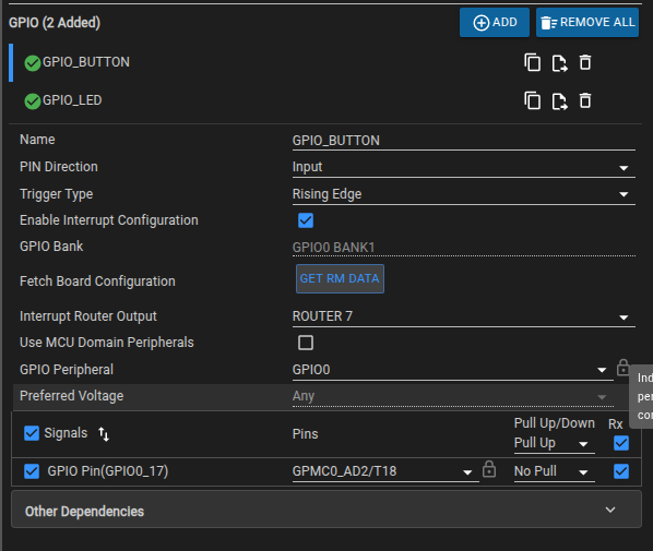

AM6442: AM6442 - GPIO Interrupt on R5 while A53 runs linux
Part Number: AM6442
CCS 21.0.0
MCU plus sdk 12.01.00.33
syscfg 1.27.0
I have an AM6442 that I am trying to get a basic gpio interrupt working. I have linux running on the A53s and FreeRTOS running on the R5F0_0. I setup syscfg in the following manner:
I am calling the Board_gpioInit function after system and board init. I've called it before and after starting the scheduler. I went into the device tree and added the following lines:
&main_gpio0 {
    status = "reserved";
&main_gpio1 {
&mcu_gpio0 {
&main_gpio_intr {
&mcu_gpio_intr {
I have also added libgpiod to my build and can confirm no gpios are detected. Even so, in Board_gpioInit the program hangs on a DebugP_assert as the call to Sciclient_rmIrqSet alwasy returns -1 (I am doing this before setting up my HwiP parameters). Below is the following sciclient setup for rmIrqSet:
struct tisci_msg_rm_irq_set_req rmIrqReq;
struct tisci_msg_rm_irq_set_resp rmIrqResp;
rmIrqReq.valid_params = 0U;
rmIrqReq.valid_params |= TISCI_MSG_VALUE_RM_DST_ID_VALID;
rmIrqReq.valid_params |= TISCI_MSG_VALUE_RM_DST_HOST_IRQ_VALID;
rmIrqReq.global_event = 0U;
rmIrqReq.src_id = TISCI_DEV_GPIO0;
rmIrqReq.src_index = TISCI_BANK_SRC_IDX_BASE_GPIO0 + GPIO_GET_BANK_INDEX(17);
rmIrqReq.dst_id = TISCI_DEV_R5FSS0_CORE0;
rmIrqReq.dst_host_irq = CSLR_R5FSS0_CORE0_INTR_MAIN_GPIOMUX_INTROUTER0_OUTP_7;
rmIrqReq.ia_id = 0U;
rmIrqReq.vint = 0U;
rmIrqReq.vint_status_bit_index = 0U;
rmIrqReq.secondary_host = TISCI_MSG_VALUE_RM_UNUSED_SECONDARY_HOST;
Any ideas what I might be doing wrong? I am new to this architecture and still working out some of the details.
  • Hello Sean,
    The first thing to check is definitely the settings to make sure you don't have a resource conflict. You can also double-check the actual Linux devicetree information that was loaded into the EVM by checking /sys/firmware/devicetree/.
    This is one thing you can try to find the GPIO nodes and make sure they are actually disabled (to rule out not actually loading the correct .dtb file during boot):

    You can also check the boot logs to see what the R5F is reporting. Refer to AM64x multicore academy > Application development on remote cores > Debug the remote core alongside Linux:

  • Hi Nick,
    Thanks for your response. I doubled check the device tree path you recommended. Mine looked like this:
    /sys/firmware/devicetree/base/gpio@600000
    I checked the status file and it reported "reserved" I also checked it for the other gpio groups and they reported reserved as well. Currently looking into this link next: https://e2e.ti.com/support/microcontrollers/arm-based-microcontrollers-group/arm-based-microcontrollers/f/arm-based-microcontrollers-forum/1063028/am64x-understanding-interrupts
    But still no luck with anything. The code always returns -1 from Sciclient_rmIrqRequest still. Nothing I have done has seem to improve the situation.

  • Hi Sean,
    Can you please check your resource allocation is correct or not for the R5F0-0 core? Are the GPIO MUX routers allocated to the R5F0-0 core?
    You can run the below command from linux userspace to see the list of allocated resources for each core.
    k3conf dump rm

  • Hi Tushar,
    Thanks for help! I added k3conf to my yocto build, I've added the output here:

  • Ok great news: After using that k3conf tool, it seems like by default the r5f1 core has access to the gpiomux interrupt router. Moving the code to that I was able to get an interrupt to occur. My next question is how do I configure the system so the r5f0 cores have access as well?
  • Hi Sean,
    Thank you for the above confirmation. To allocate resources to R5F0-0 core, you can use the k3-resource partitioning tool.
    Please refer  [FAQ] How to use K3 resource partitioning tool with Processor SDK v9.0 or v9.1? for details on resource partitioning tool usage.
