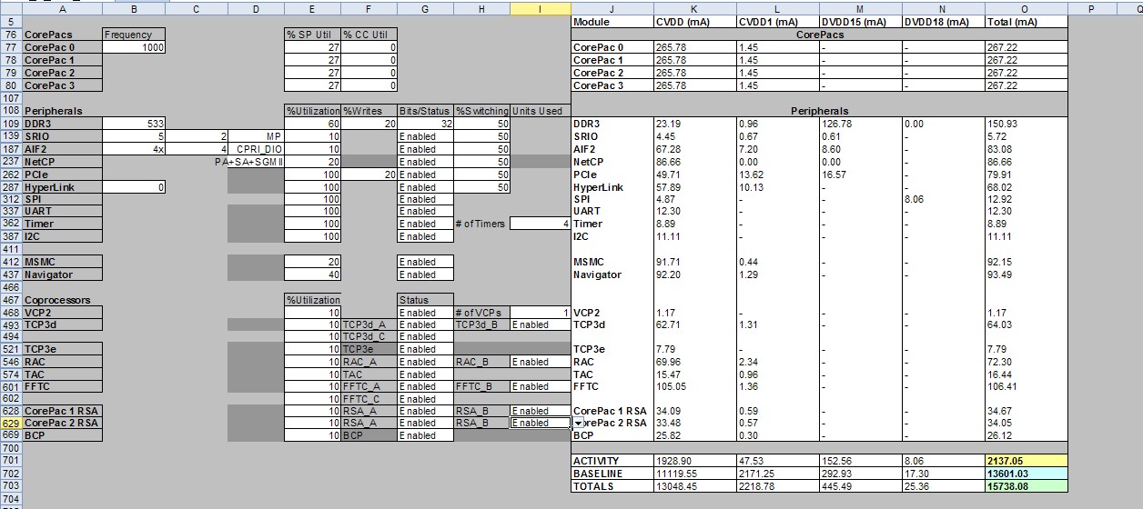

    I use C6670's  power consumption model,but i'm not familiar to the table, I refer to the C6678's setting to get the result as follows:
    Bill,could you help me to analyze the table,whether 10A is enough for my design?

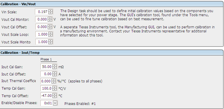

    what's more, I use Fusion Software to monitor  the voltage and current, some of my setting is as follows:
    I wanna know the parameters  Iout Cal Gain and Iout Cal Offset  affect the real output current of  9222? Or just affect the display current of the software??
    (If I set  the  Iout Cal Gain=100, the current display is about 4A and power down near 6A;  However, if  Iout Cal Gain=100,the current is 8A, and  power down near 10A )

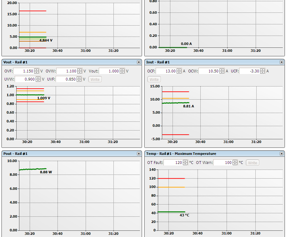

    The following picture shows the current ,power and voltage after loading fpga codes,but without connect cores in CCS; I'm puzzling why the current is so large even without connecting cores? If I don't load fpga codes,the current is about 6A.
  • Hi Chen Jie,
    Based the image of the power consumption model you've attached 10A is not enough for your design. The CVDD column defines the necessary current for the CVDD voltage rail. You're spreadsheet displays 11.119A in baseline current and 1.928A of active current for a total requirement of 13.048A. The baseline current is normal current draw due to leakage and other baseline activities.  This current draw should be present regardless of the activity of the cores. The active current is additional current that will be present when the cores are operating at the level you have specified in the model. I am not sure what you mean by loading fpga codes but it is not unusual to see current levels of 8 amps or higher before the devices is actively in use.
    The Fusion software uses the current monitoring capability of the UCD9222 and the UCD7242 to generate the information shown on the monitoring page. This information is only accurate if the software has been configured for the components used in your design. The details of how the current monitoring is achieved are described in the data manuals for the UCD components. The calibration settings in the Fusion software allow you to tune the outputs for your design to get more accurate readings. They do not effect the amount of current provided by the UCD7242 power stage, only how it is displayed. If you do not have the proper information for the components in your design and the proper calibration values loaded into Fusion the current measurements displayed will not be accurate. Note that these measurements are also used to determine the overcurrent state so it's important to get the settings correct. You should contact the power supply group supporting the UCD components if you have more questions setting up the current measurements.
