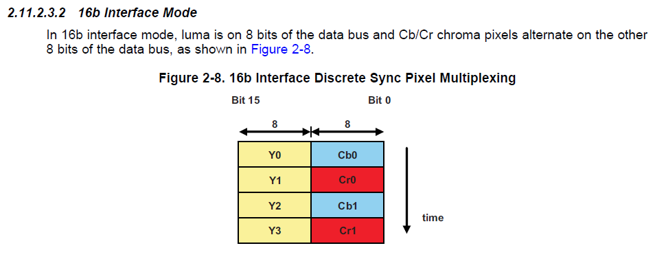

  • We have our decoder set up as follows:
            .name    = TVP7002_INST1,
            .board_info =
                I2C_BOARD_INFO("tvp7002", 0x5c),
                .platform_data = &tvp7002_pdata,
            .vip_port_cfg =
                .ctrlChanSel = VPS_VIP_CTRL_CHAN_SEL_15_8,
                .ancChSel8b = VPS_VIP_ANC_CH_SEL_DONT_CARE,
                .pixClkEdgePol = VPS_VIP_PIX_CLK_EDGE_POL_RISING,
                .invertFidPol = 0,
                .embConfig =
                    .errCorrEnable = 1,
                    .srcNumPos = VPS_VIP_SRC_NUM_POS_DONT_CARE,    // ?????
                    .isMaxChan3Bits = 0,
                .disConfig =
                    .fidSkewPostCnt = 0,
                    .fidSkewPreCnt = 0,
                    .lineCaptureStyle =
                        VPS_VIP_LINE_CAPTURE_STYLE_DONT_CARE,
                    .fidDetectMode =
                        VPS_VIP_FID_DETECT_MODE_DONT_CARE,
                    .actvidPol = VPS_VIP_POLARITY_DONT_CARE,
                    .vsyncPol =  VPS_VIP_POLARITY_DONT_CARE,
                    .hsyncPol = VPS_VIP_POLARITY_DONT_CARE,
            .video_capture_mode =
                VPS_CAPT_VIDEO_CAPTURE_MODE_SINGLE_CH_NON_MUX_EMBEDDED_SYNC,
            .video_if_mode = VPS_CAPT_VIDEO_IF_MODE_16BIT,
            .input_data_format = FVID2_DF_YUV422SP_UV,    // or FVID2_DF_YUV422SP_VU,
    We are inputting the same video as section 2.11.2.3.2 in the TRM into the DM8168. I've tried fiddling with the settings but no luck. What does "ctrlChanSel" mean in the above by the way?
    Ralph

  • Hi Ralph
    could you please tell the detail about your handling of this?
    i have the same ploblem,and i really need to solve it. thanks.
  • You need to search for a loop "for (i = 0; i < 1; i++)" in ti81xxvin_main.c and change the 1 to a 2.
    The other change in this file which I did was to make sure the line "inst->curr_subdev_info = &config->subdev_info[1];" was used in function ti81xxvin_open to select the correct encoder settings for using the second video input.
    And don't forget to setup your pin muxes properly.
    And don't forget to setup the encoders correctly in ti81xx_vpss.c.
    And don't forget to comment out the I2C calls in tvp7002.c.
    Ralph
  • Hi Ralph,
    Could you please have a look at this topic,
    http://e2e.ti.com/support/dsp/davinci_digital_media_processors/f/717/t/210766.aspx
    I want to know were you using embedded 16bit yuv422 video as vip1's input.
    Do we need modifiy pinmux settings like this:
    board-ti8168.c
    static struct omap_board_mux board_mux[] __initdata = {
     /* PIN mux for non-muxed NOR */
     TI816X_MUX(TIM7_OUT, OMAP_MUX_MODE1), /* gpmc_a12 */
     TI816X_MUX(UART1_CTSN, OMAP_MUX_MODE1), /* gpmc_a13 */
     TI816X_MUX(UART1_RTSN, OMAP_MUX_MODE1), /* gpmc_a14 */
     TI816X_MUX(UART2_RTSN, OMAP_MUX_MODE1), /* gpmc_a15 */
     /* REVISIT: why 2 lines configured as gpmc_a15 */
     TI816X_MUX(SC1_RST, OMAP_MUX_MODE1), /* gpmc_a15 */
     TI816X_MUX(UART2_CTSN, OMAP_MUX_MODE1), /* gpmc_a16 */
     TI816X_MUX(UART0_RIN, OMAP_MUX_MODE1), /* gpmc_a17 */
     TI816X_MUX(UART0_DCDN, OMAP_MUX_MODE1), /* gpmc_a18 */
     TI816X_MUX(UART0_DSRN, OMAP_MUX_MODE1), /* gpmc_a19 */
     TI816X_MUX(UART0_DTRN, OMAP_MUX_MODE1), /* gpmc_a20 */
     TI816X_MUX(SPI_SCS3, OMAP_MUX_MODE1), /* gpmc_a21 */
     TI816X_MUX(SPI_SCS2, OMAP_MUX_MODE1), /* gpmc_a22 */
     TI816X_MUX(GP0_IO6, OMAP_MUX_MODE2), /* gpmc_a23 */
     TI816X_MUX(TIM6_OUT, OMAP_MUX_MODE1), /* gpmc-a24 */
     TI816X_MUX(SC0_DATA, OMAP_MUX_MODE1), /* gpmc_a25 */
     /* for controlling high address */
     TI816X_MUX(GPMC_A27, OMAP_MUX_MODE1), /* gpio-20 */
    #if 1//for vip1 input   added
     TI816X_MUX(TSI1_DCLK, 0x1A),      //VIN[1]A_D[9]
     TI816X_MUX(TSI1_DATA, 0x1A),      //VIN[1]A_D[10]
     TI816X_MUX(TSI1_BYTSTRT, 0x1A),  //VIN[1]A_D[11]
     TI816X_MUX(TSI1_PACVAL, 0x1A),  //VIN[1]A_D[12]
     TI816X_MUX(TSI1_PACERR, 0x1A),  //VIN[1]A_D[13]
     TI816X_MUX(TSI2_DCLK, 0x19),   //VIN[1]A_D[14]

  • Yes, we used embedded 16bit yuv422 video as vip1's input. I don't have time to check over your pin mux settings, sorry.
    Ralph
  • Hi Ralph,
    Sorry Mayby I did't  describe my issue clearly.I mean whether   we "need" modify pinmux settings,not  particular pinmux settings.
    thanks a lot.
  • You could change the pinmux settings in mux81xx.c file.
    Thx,
    Brijesh
    Ah I understand. IIRC, the default TI pin mux settings worked for us for VIP0, VIP1, DVO2 but not DVO1 (DVO1 is linked to HDMI).
    If you want DVO1 to output video, you must lose VIP1 functionality and change the pin mux settings. This is because some DVO1 pins are shared with VIP1 pins.
    Ralph
