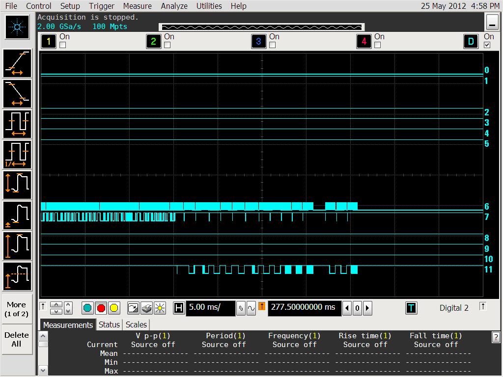

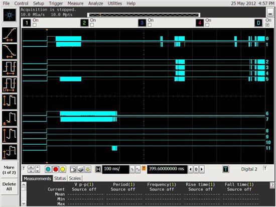

In the upper picture, there is a scope screenshot representing SD-Card interface signals of 2 booting boards in parallel immediately after the power-up phase.
The traces represent the following signals:
0 – BOARD1 SD_CLK
1 – BOARD1 SD_CMD
2 – BOARD1 SD_DAT3
3 – BOARD1 SD_DAT2
4 – BOARD1 SD_DAT1
5 – BOARD1 SD_DAT0
6 – BOARD2 SD_CLK
7 – BOARD2 SD_CMD
8 – BOARD2 SD_DAT3
9 – BOARD2 SD_DAT2
10 – BOARD2 SD_DAT1
11 – BOARD2 SD_DAT0

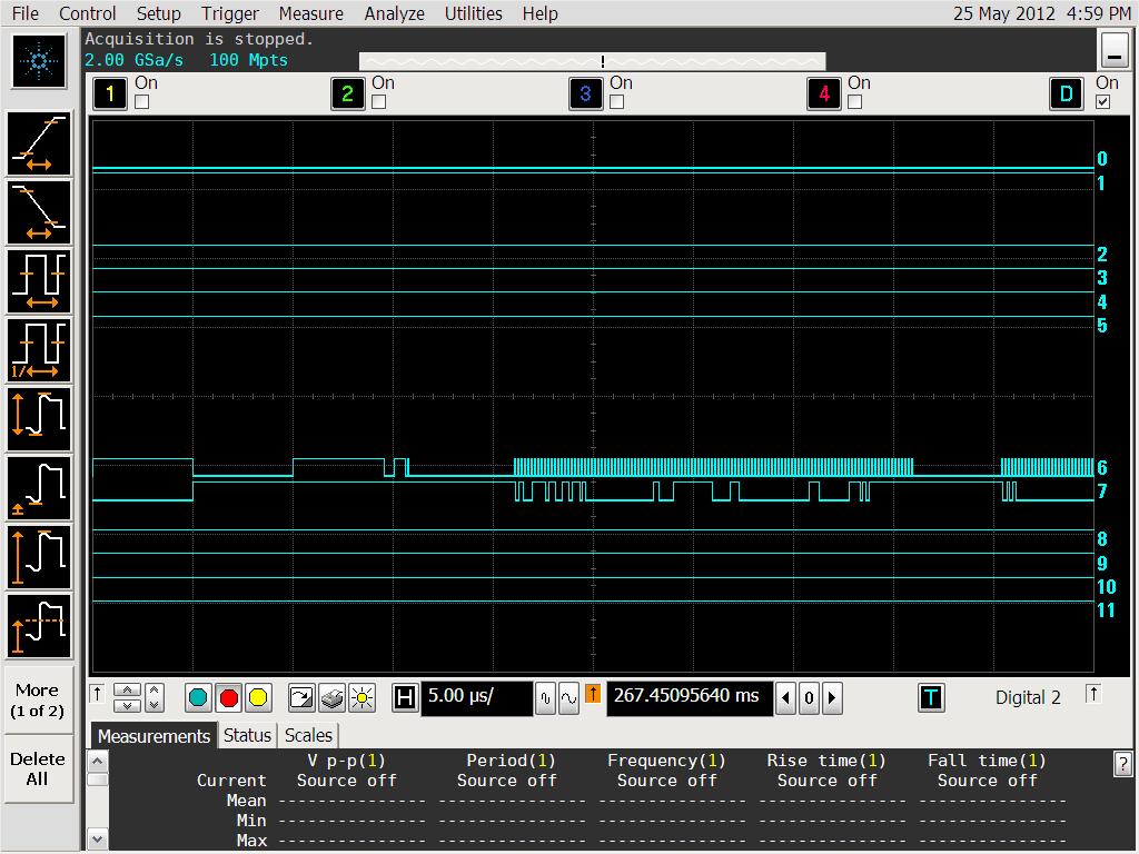

BOARD1 (upper traces) boots correctly: it starts with a 125 kHz clock, after a while the clocks switch to 6 MHz and later all 4 data lines are used
BOARD2 (lower traces) stops the boot: the 125 kHz phase is much longer than BOARD1, nevertheless the clock switches to 6 MHz (see the trace number 6 in the following picture).
 BOARD2 seems to stop the SD-Card booting phase.
On the analog scope all the signals seems to be quite clean without overshoot or undershoot, crosstalk and so on.
