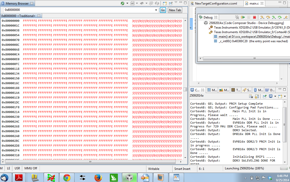

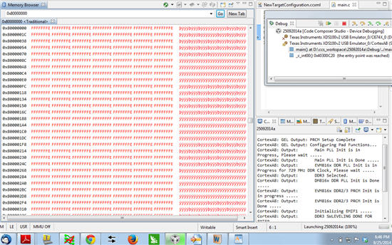

  • Dear Pavel,
      Thanks for your replay!
     I am using evm816x.gel  of Version 1.02. Attaching GEL file.
     And I got some clue over this,It's Bit strange, I was trying  to load GEL file with different DDR speed in that with 400,531,756, 783, 796 MHz DDR1 RESET signal is not initiating but with 621, 634, 648, 675, 702, 729Mhz frequency it's initiates and processor sends reset to DDR ,so getting control over the same. Question is why it is not loading with lower and higher Frequency?
     And one more problem getting is, I was trying to fill 0XFFFFFFFF data to some memory location. In that lower bit is not writing properly to some location.Attaching the snap of memory browser.
    Please give some advice for the same!

  • Dear Pavel,
         We have disabled DDR interleaving in GEL file.
    /*Program the DMM to Access EMIF0 and 1*/
    WR_MEM_32(DMM_LISA_MAP__0, 0x80500100); // Interleaved 1GB section from 0x80000000
    WR_MEM_32(DMM_LISA_MAP__1, 0xC0500120); // Interleaved 1GB section from 0xC0000000
    WR_MEM_32(DMM_LISA_MAP__2, 0x80500200);
    WR_MEM_32(DMM_LISA_MAP__3, 0xC0500220);
      After changing this able to write correct data to on both DDR ranks (i.e. to 0X80000000 and to 0XC0000000) and we have tried with some test pattern for DDR, it is passing. (FYI ,Here Previously 0th bit was not writing proper).
    So we have modified same to DMM_LISA_MAP Registers in u-boot, But status is same. Can you give some suggestion over this?
    Or is there anyway to load u-boot to DDR through CCS?
    Pragnesh Virani
  • Pragnesh,
    This seems to be DDR3 HW design issue. Please check:
