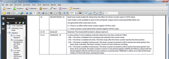

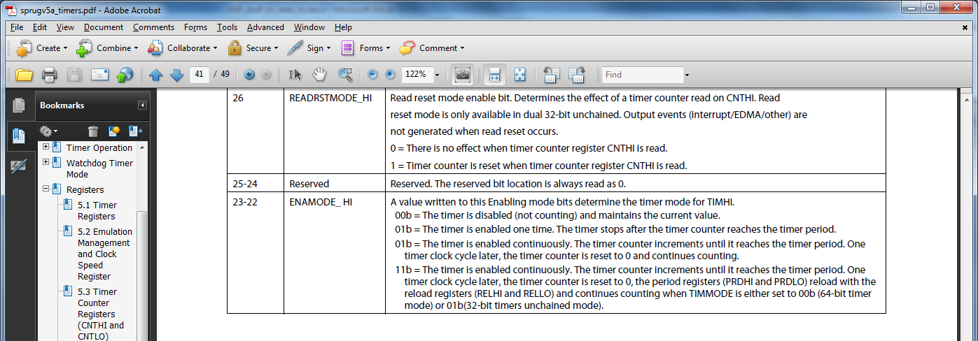

  • Also, what is the difference between mode 2 and mode 3?  What is the purpose of the "reload" registers?  If they are continuous then why the difference?  Also, there seems to be a typo.
  • Brandy,
    I've asked someone to help look into the issue with NDK/timer resouces, but I think I can answer the question about the reload registers.  If you see section 3.9.5 of http://www.ti.com/lit/ug/sprugv5a/sprugv5a.pdf, you'll notice that the timer registers can't be written with an active timer.  So if you ever wanted to change the timer period registers while in continuous mode, you'd have to stop the counter first.  Alternatively, you can write the reload registers while the counter is active and the period registers are automatically loaded with the new values at the point when the counter=period and the counter starts over.
    I see the typo and will have it fixed.
    Hope that helps,
    Travis
