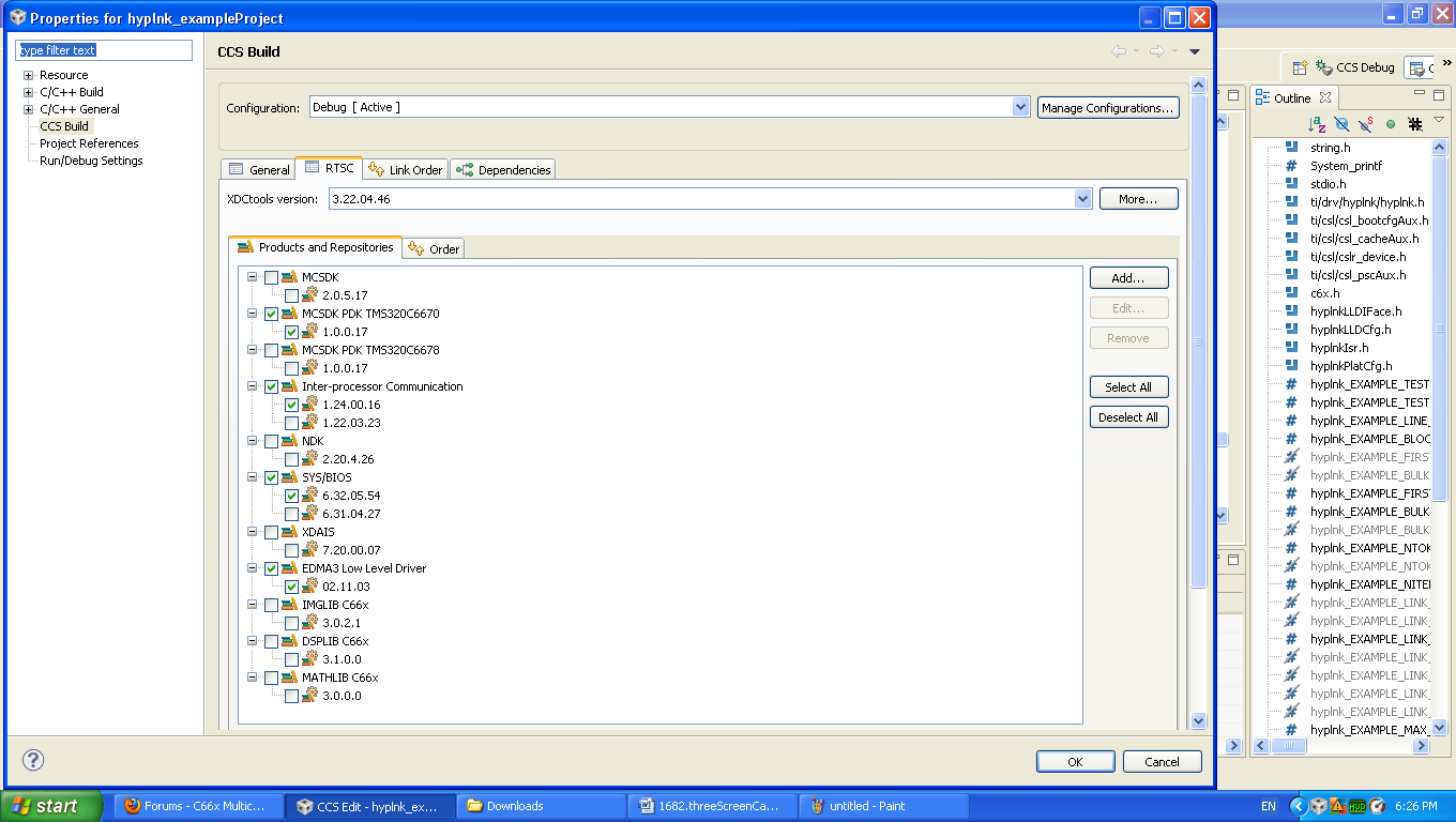

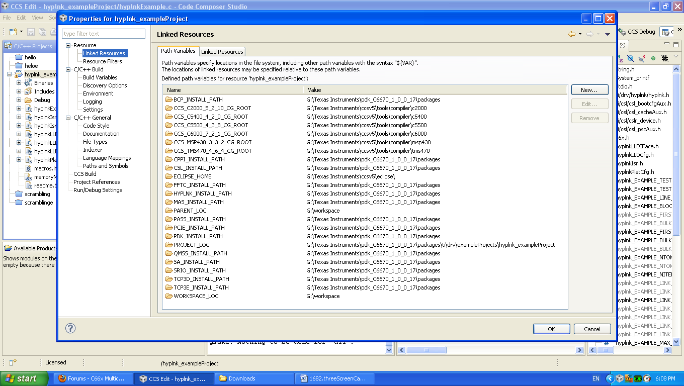

  • I just built the example (for release 19,  I do not have release 17 on my system) and did not see any linker command file.
    Here is my suggestion
    Try first to build the example excactly as it comes from the release. I assume that you installed all the tools and everything in the default locations.
    Now I installed my release in c:\ti   - you did apparently in G:\Texas Instruments.  I will give you three screen captures that you can compare with yours (of course translate the  c:\ti to your location)   The first one is the list of link resource and you get it from the property page of the project at the resource tab.  The second one is the definition of the platform - again from the proprerty page, and the last one is the include paths.  What I am looking for is a descrepency between your setting and mine.
    Look at report back to me
    Thanks    Ran

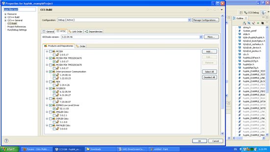

  • Dear ran,
    i built the project as you suggested but there is a little difference between my settings and you this is the screen shots  in turn as you sent me

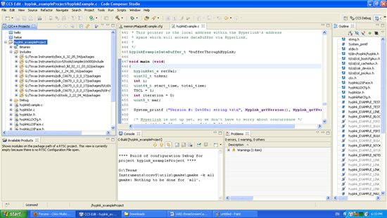

    Description  :
    Invalid project path: Duplicate path entries found (/hyplnk_exampleProject [Include path] isSystemInclude:true includePath:G:/Texas Instruments/pdk_C6670_1_0_0_17/packages), path: [/hyplnk_exampleProject].

  • Hi abdalrahman
    I believe you can safely ignore the "Invalid project path: duplicate path entries" warning.
    It seems to be an unresolved Eclipse bug; see http://e2e.ti.com/support/development_tools/code_composer_studio/f/81/p/105388/372043.aspx#372043
    Other than the warning above, are you seeing any of the memory-map-related errors you initially reported or any other errors during compilation?
