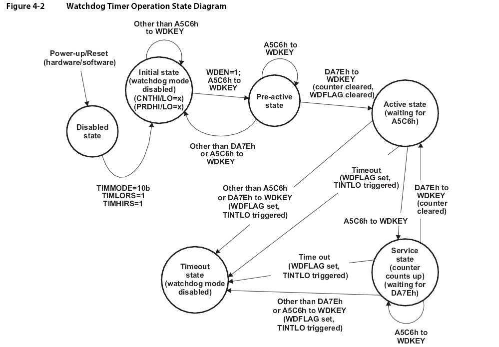

    Q1:In initial statue, I enable the wd and key A5C6h to WDKEY,we are into pre-active state.That is right.
    And then,the problem is occured.
    Write DA7Eh to WDKEY.it should into Active state(In the state, we are waiting for A5C6h).
    That means the counter still remain 0 if I didn`t write A5C6h to WDKEY. I`m right?
    The fact is when I have write A5C6h and DA7Eh  first time.(It should into Active state and wait A5C6h)
    But it start counting. It make me confused.

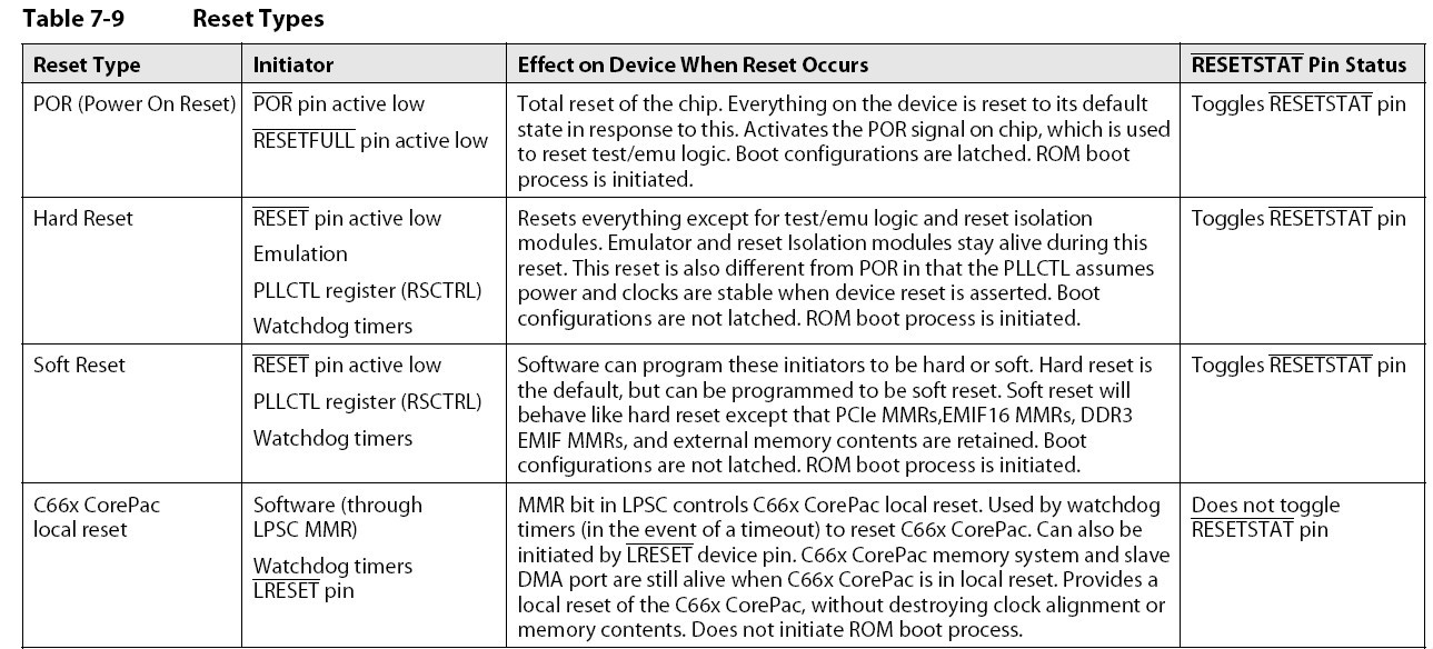

    Q2:I think the watchdog timer can realize hard reset, soft reset and,local reset.as the following image

  • Hi Chad,
    I feel confuse about how to make timer-watchdog mode realize soft reset / hard reset / Local reset.
    The Manual describe the different of these.
    But I feel it is not detailed about realize them.
    And For example,If i want to use soft reset,I must set 1 at WDTYPE[N] in RSTCFG (PLL register),
    I have tried it,but the bit can`t be written like only read,though it is  R/W.

  • Hi Li,
    Q1: You're right, it should not start couting until it receives the watchdog key "A5C6h". You said "That fact is when I have write A5C6h and DA7EH", if you did write those, it should start counting, if you did not write those, it should remain 0 and go into the Time Out state. However, you may have accidently written to it the A5C6h value it needs.

  • Hi Li,
    Q1: Li, I think once you write both A5C6H and DA7EH, the watch dog will count. In state one of that diagram in order to go into state 2 (inital state watchdog mode) and then into state 3 (Pre -active state) you have to have WDKEY = A5c6h. In order to go into state 4 (Active State) you have to have DA7eh. I think what is happening is that in your code you have the EVM or device or your 6678 chip responding with the A5C6H. So it is telling the code to continue to kick or wake the dog.
    Q2: I don't understand what you're asking here exactly, but different reset types can be done on board with a button or in software like you did via CCS. (You can get more information about this in the 6678 user guide on page 127 and page 139 at http://www.ti.com/lit/ds/symlink/tms320c6678.pdf ) Toggling back and forth the WDTYPE in the RSTCFG from 0 to 1 or 1 to 0 should cause the hard reset or soft reset you need based on how you programed the 12 bit for Reset type in RSTCFG. I know this is probably an obvious question, but you are connecting back the EVM and doing the basic configurations between resets, correct?
    Q3:  Yes, this example like all of TI example packages goes through a check and correct process to make sure it is valid and working well for customers. I can assure you it has worked here at TI and for other TI device users.
    Q4: Since soft/local/hard resets are such a basic feature for every chip and device that TI produces, there isn't an example for purely that. Every TI engineer has done this process since it is cruical for JTAG debugging.  I suggest looking at the EVM page (http://processors.wiki.ti.com/index.php/TMDXEVM6678L_EVM_Hardware_Setup). There are hardware buttons ON the board that you can reset the system with and software methods as you did before. Both are considered TI approved ways to reset the system for the device, respectively.  There is also the EVM specific EVM refence manual that may be helpful to you as well (http://www.advantech.com/Support/TI-EVM/6678le_sd.aspx )  and a getting started guide. These should have some more answers as far as resets.

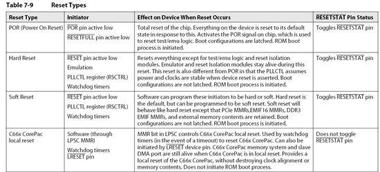

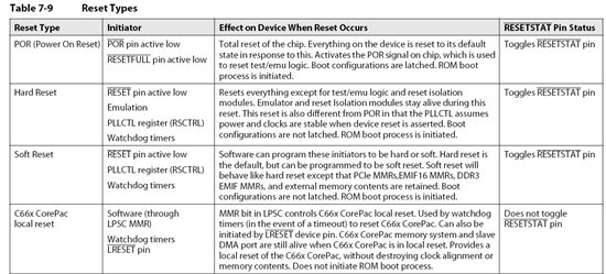

  • Hi Piyush,
    TI example:..\ti\pdk_C6678_1_1_2_5\packages\ti\csl\example\timer, I use it setup timer.
    Some error about procedure as I said before. But I think it can`t make Hard reset become invalid.
    As the image, You can know many ways to perform Hard Reset. We can use PLLCTL perform HR in WD timeout interrupt routine.
    I have try what you do.But actually it seems can`t work.So I use PLLCTL.It`s looks very well.  :D
    Li
  • Hi Li,
    I can perform PLL reset but not automatically using watchdog. Thanks you for your help.
