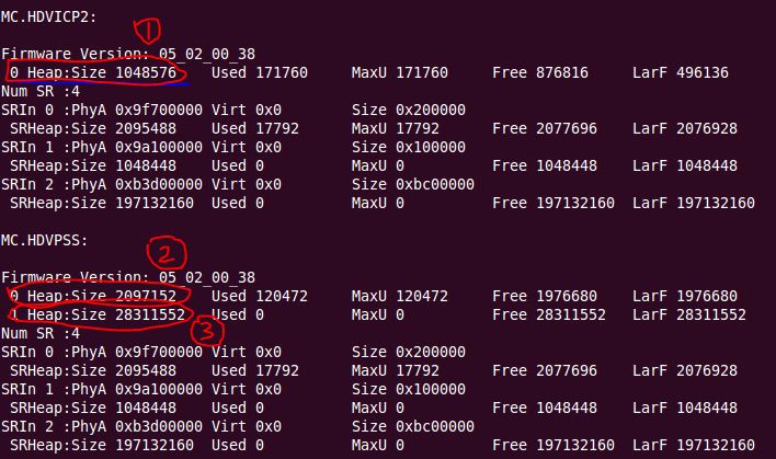

Issue of increasing HDVICP2 heap memory (DM8168)
I am using DM8168 with EZSDK_504.
Now i am facing a heap memory issue of HDVICP2 for I need create above 10 codecs.
The below HDVICP2's heap  0. Heap:Size 2097152 (with green underline) is used up when i create more than 10 codecs, no matter what resolutions they are, CIF or HD.
My question is what this heap is and how to increase this heap  memory size?
As per memory map: http://processors.wiki.ti.com/index.php/EZSDK_Memory_Map#Memory_Map_in_the_current_EZSDK_.28version_5.02_onwards.29
I increased the  MC_HDVICP2_INT_HEAP_CACHED (VIDEO_M3_INT_HEAP_CACHED) form 24MB to 48MB, but the  above heap size remains the same(2097152).
Then I thought perhaps this heap  is "VIDEO_M3_EVENT_BUFFER" ,  so I modified "omx_05_02_00_38\src\ti\omx\build\MemSegmentDefinition.xs" and rebuild the OMX. But the heap size is not changing either.
Please help.

  • Hi Pavel,
    Thanks for your reply.
    The guide above instruct how to allocate more memory on shared region(sr0,sr1,sr2) and M3's internal heap (VIDEO_M3_INT_HEAP_CACHED, VPSS_M3_INT_HEAP_CACHED).
    The heap I mentioned is not these ones.
    As sys_top shows( green underline in the above picture),  this 2MB  is not SR0,1,2 and M3's internal INT_HEAP_CACHED.
    I am now stuck on increase this one, for it will be used up when allocate more codecs.
    Does this heap is provided within HDVICP2 binary, which means I should get the source of HDVICP2 and recompile it?
    Llano
  • Hi Llano,
    The green underlined heap is exactly the Video-M3 (HDVICP2) internal heap size.
    Can you double check that following the instructions, you can not increase the size.
    Pavel

  • Hi Llano,
    The HDVICP2 internal/local heap (VIDEO_M3_INT_HEAP_CACHED) is used for codec memory allocation. And from what I understand, you need exactly this type of heap.
    By default this heap size is 25MB, see memsegdef_default.c file:
    /* Segment 2 , Temporarily used by VFPC internal buff heap */
       1,                           /* valid */
       "VIDEO_M3_INT_HEAP_CACHED",  /* name */
       0x01800000,                  /* size */
       LDR_SEGMENT_TYPE_DYNAMIC_LOCAL_HEAP,        /* seg_type */
       0,                           /* flags */
       0x9BD00000,                  /* system_addr */
       0x9BD00000,                  /* slave_virtual_addr */
       -1,                          /* master_core_id */
       (1 << LDR_CORE_ID_VM3),      /* core_id_mask */
       1,                           /* cache_enable_mask */
       0,                           /* cache_operation_mask */
       -1                           /* shared_region_id */
    In the How_to_increase_Heap_memory_available_to_VPSS_and_VICP_M3_cores_v2.docx is described how you can enlarge this heap size to 52MB.
    Even though the sys_top utility does not report the current VIDEO_M3_INT_HEAP_CACHED size, do you have problems when you create more than 10 codecs with 52MB heap?
    Pavel

  • Hi Pavel,
       1,                           /* valid */
       0,                           /* flags */
    As you pointed,  "VIDEO_M3_INT_HEAP_CACHED"'s heap size should enlarge to allocate multiple codecs and I have successfully done that.
    Right now, the problem is, when I try to allocate more, not the VIDEO_M3_INT_HEAP_CACHED is insufficient, but the following 1048576(1MB) heap is insufficient.
    After allocate 4 codecs, this heap's free size will decrease to about 100KB.  So, what this heap? How can I increse it?
    Llano
  • In this picture #1 is HDVICP2 system heap, #2 is HDVPSS system heap and #3 is HDVPSS internal heap (same as VIDEO_M3_INT_HEAP_CACHED in memsegdef.c)
    It is the bug with release not to display internal heap (same as VIDEO_M3_INT_HEAP_CACHED in memsegdef.c) for HDVICP2, this will be fixed in subsequent releases.
      A new section add to http://processors.wiki.ti.com/index.php/EZSDK_sys_top_Linux_Utility#How_to_interpret_sys_top_output to describe these in more details.
    Thanks & Regards
    Velan

  • Hi Velan,
    I am clear now. Many thanks to your work on sys_top wiki. I have read that and several related system heap posts.
    Could you point me out where can I get a guide to increase this #1 is HDVICP2 system heap size?
    Do I have to get HDVICP2's source code and rebuild it?
    Llano

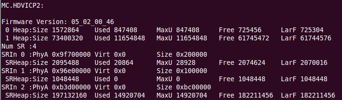

  • Hi Velan,
        In the wiki page, you said that there is a .cfg file which defines the HDVICP2 system heap. I want to know where could I find the file and whether could I modify that to change the heap size. As the sys_top command could show the size of this heap, it must be read from the .cfg file.
        I and Llano met the same problem when creat several channels of decoder or encoder. Could you help us to solve the problem so as we can move on?  We  appreciate your replay!
  • To increase the #1 HDVICP2 system heap, you need to change the memory section and rebuild the M3 firmwares. This can be done by installing and then using the "EZSDK overlay installer". Please contact your local FAE for more details how to download, install and use the "EZSDK overlay installer".
    Pavel
  • Hi Pavel,
        Thanks for your kindly replay! I update my board with the latest ezsdk 5.05, and now the #1 HDVICP2 system heap is 1.5M in default. I modify the memsegdef_default.c to enlarge the VIDEO_M3_INT_HEAP_CACHED to 72M. Now I can manage to creat and run 8 channels of decoder at the same time.The input video format is 1280*720 15P. But when I increase the channels up to 9 or more, the OMX_Send_Cmd() function will release "OMX_ErrorInsufficientResources (0x80001000)". I change the input video to 640*480 15P and 320*240 15P, the result is the same as 1280*720 15P . The sys_top command shows that the  "#1 HDVICP2 system heap" and "VIDEO_M3_INT_HEAP_CACHED" are both sufficient to use. So, I don't know which kind of resource is use-up as  "OMX_ErrorInsufficientResources (0x80001000)" indicates. The following is the usage of the HDVICP2 when the input video format is 320*240 15P, and 8 channels of decoders run at the same time.
    I appreciate your replay !

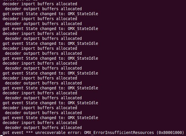

    OMX_ErrorInsufficientResources can indicate several error conditions like unable to allocate memory, error in creating event, error allocating pAppData, error in allocating resources in main, error in event retrieve.
    Can you post the piece of code that logs/reports the OMX_ErrorInsufficientResources error, and in which C file ? You can examine the  ti-ezsdk_dm816x-evm_5_05_01_04/component-sources/omx_05_02_00_46/examples/ti/omx/demos/decode/src/decode_test.c file.
    I can not locate OMX_Send_Cmd() function in the EZSDK. Do you mean OMX_SendCommand() instead?

        The following is the part of code which reports the OMX_ErrorInsufficientResources after the inbuf and outbuf had been allocated. I am sorry for making mistakes about the name of OMX_SendCommand() function. I post the cmd output when running the program in the end, and you could have a look.
    for(j=0;j<Decode_Channel;j++)
    int flag=0;
    eError =
    OMX_SendCommand (pAppData->pDecHandle[j], OMX_CommandStateSet,
    OMX_StateIdle, NULL);
    //printf("send cmd success %d\n",j);
    if (eError != OMX_ErrorNone)
    printf ("Error in SendCommand()-OMX_StateIdle State set : %s \n",
    IL_ClientErrorToStr (eError));
    goto EXIT;
    /* Allocate I/O Buffers; component would allocate buffers and would return
    the buffer header containing the pointer to buffer */
    for (i = 0; i < pAppData->decILComp[j]->inPortParams->nBufferCountActual; i++)
    eError = OMX_AllocateBuffer (pAppData->pDecHandle[j],
    &pAppData->decILComp[j]->inPortParams->pInBuff[i],
    OMX_VIDDEC_INPUT_PORT, pAppData,
    pAppData->decILComp[j]->inPortParams->nBufferSize);
    printf ("Error in OMX_AllocateBuffer()- Input Port State set : %s \n",
    goto EXIT;
    printf (" decoder inport buffers allocated \n ");
    /* buffer alloaction for output port */
    for (i = 0; i < pAppData->decILComp[j]->outPortParams->nBufferCountActual; i++)
    &pAppData->decILComp[j]->outPortParams->pOutBuff[i],
    OMX_VIDDEC_OUTPUT_PORT, pAppData,
    pAppData->decILComp[j]->outPortParams->nBufferSize);
    printf ("Error in OMX_AllocateBuffer()-Output Port State set : %s \n",
    goto EXIT;
    printf (" decoder outport buffers allocated \n ");
    /* Wait for Idle stete of component after all buffers are alloacted componet would chnage to idle */
    semp_pend (pAppData->decILComp[j]->done_sem);

  • Hi Bing,
    It is not possible to go beyond 8 channels with EZSDK. For multichannel, DVR RDK is recommended, where you can modify the M3 source code and go beyond 8 channels.
    Can you provide more details for your use-case?
    Pavel
  • Hi Pavel,
         Thanks so much for your replay. We want to use EVM8168 board as a media-server for a video conference. The conference has 24 participants at the maximum, and each participant would send a h264 format video stream to the media-server. The media-server would receive these video streams and decode them all, then the server will mix some of these uncompressed video together and encode the mixed video using h264 format.
        So, the board  could have to do 24 channels of decoding at the worst situation. As the EZSDK supports 8 channels at most, I wonder if we could use one decoder to decode 3 video one after another, I mean decode 1 frame of video1, then 1 frame of video2, and 1 frame of video3, just in turn.
