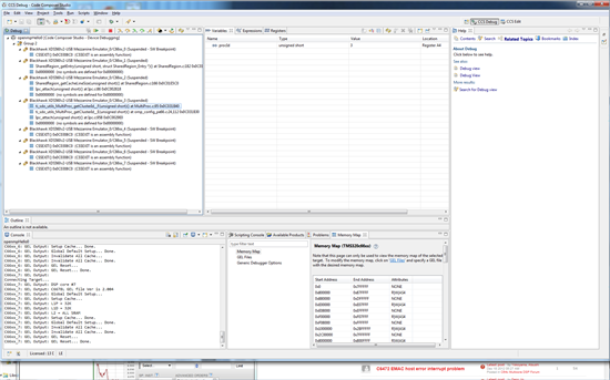

I try to run the simple hello OPENMP example on EVM6678. The CCS version is 5.2, windows 7, 64 bit OS. The tools are:
IPC: 1.24.3.32
MCSDK: 2.1.2.5
MCSDK PDK: 1.1.2.5
OPENMP library: 1.1.3.02
SYS/BIOS: 6.33.6.50
After the launching, the core1,2 and 3 are automatic in running state. There is no expected message echo in the console. This is quite different with the previous project launch. I pressed teh pause button, it shows these cores have different modules. I do not see the source code or the .cfg code do the partion job. What is wrong? Thanks

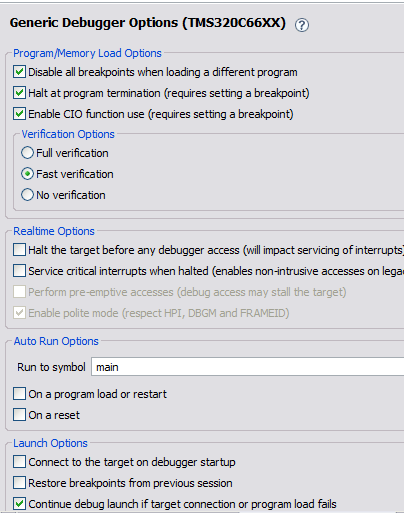

    I was able to run your executable and get the expected output on the console. Could you please try the following before you load the .out file on the cores:
    1. Launch target configuration (.ccxml for 6678 EVM)
    2. Connect to the target (four cores)
    3. Select Core 0, go to Tools --> Debugger Options --> Generic Debugger Options. This should bring up a window as below. Please uncheck the option that says "On a program load or restart."
    4. Repeat this process for the other three cores.
    5. Now load the .out file on all four cores and run.
    6. You should see the following output on the console (not necessarily in the same order)
    [C66xx_0] Hello World from thread = 0
    [C66xx_0] Number of threads = 4
    [C66xx_2] Hello World from thread = 2
    [C66xx_1] Hello World from thread = 1
    [C66xx_3] Hello World from thread = 3
