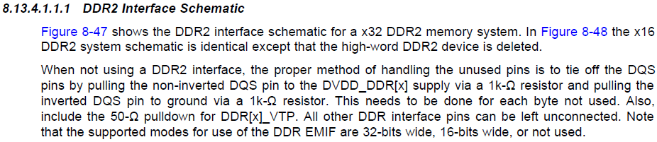

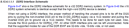

I have a question about AM3357 DDR I/F.
I have no plan to use external memory, so how to handle unused DDR I/F pin ?
I checked the following TI wik:
http://processors.wiki.ti.com/index.php/AM335x_Schematic_Checklist#Unused_Signals
But there was no infomation about unused DDR pin.
My guess is like following:
Only VDDS_DDR pins need to be connect to the ground
and other pins are NC.
Is it right?
