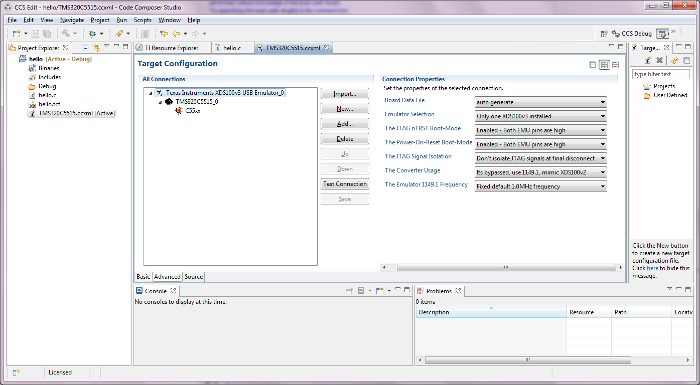

I'm posting because we had problems with one of our designs where we use TMX320VC5515. We tried numerous times to download code using Code Composer Studio with many alternative configurations in the TMS320C5515.ccxml. We are using OLIMEX XDS100v3 debugger. So far the errors got from CCS were of that kind:
Error connecting to the target:
(Error -182 @ 0x0)
The controller has detected a cable break that is near-to itself.
The user must connect the cable/pod to the controller.
(Emulation package 5.0.747.0)

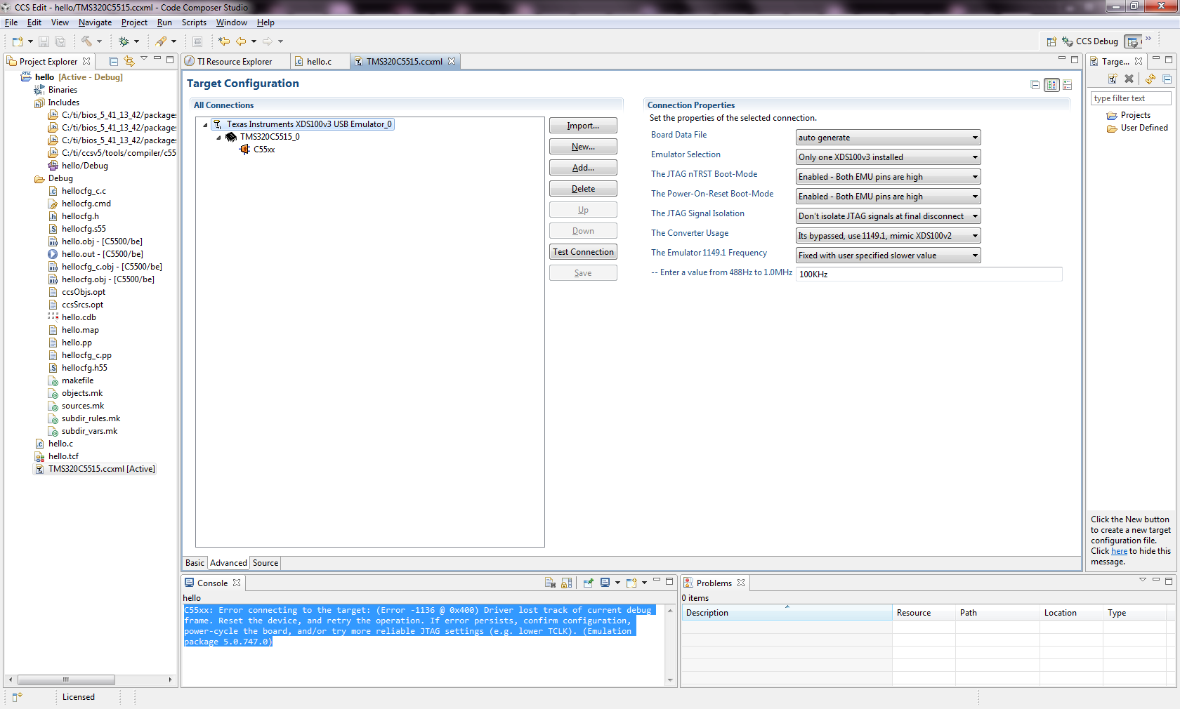

The configuration we used last was
And after clicking Test Connection we got:

  • Hello HRi!
    Thnx for the quick response. I looked at the link you posted and found out i had some errors regarding the pinout of the jtag. I followed the instructions that i found and now when i click Test Connection with the options below:
    i get

    But when i try to Debug with that configuration i get the message:
    C55xx: Error connecting to the target: (Error -1136 @ 0x400) Driver lost track of current debug frame. Reset the device, and retry the operation. If error persists, confirm configuration, power-cycle the board, and/or try more reliable JTAG settings (e.g. lower TCLK). (Emulation package 5.0.747.0)
    I tried lower TCLK as you may see from the test above(100kHz) but i still get the same error message. Do you have any tips on this? Thanks again.
