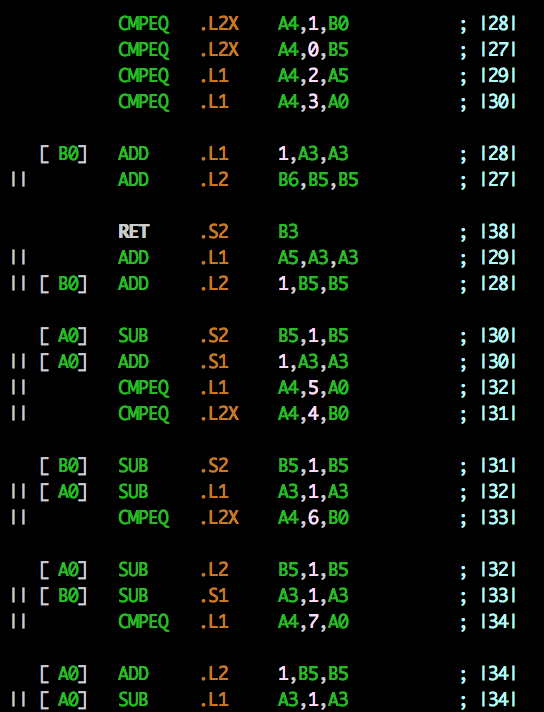

  • I'll echo Randy's suggestion you reconsider C, especially C with intrinsics.  With a few careful #pragmas, use of the 'restrict' keyword, and so on, you can often do quite well from C.   I've been programming the C6000 family since before its introduction.  I was a hard-core assembly programmer in the beginning.  (I think Randy's seen my work. ;-) )  Now I do just about everything in C and C++.
    If you insist on assembly, though, you might consider the linear assembler.  As I recall, you can't really do a switch-table from linear assembly, but for a switch-case with only 9 cases, you're probably better off doing 8 compares and branches, with a fall-through case.  That's true for hand-coded assembly also.  You can schedule branches in each others' delay slots.
    If the cases in your switch-case are relatively short, you may be better off rewriting the switch-case as a series of if-statements, so they convert to predicated instructions.  (This is true whether you're writing C or assembly.)  The C6x family relies heavily on predicated instructions to reduce costly branching, and you can use this to your advantage.

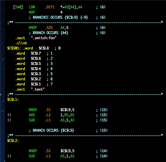

    For example, consider this imagined example where the 9 cases corresponded to moving one of 8 directions, or staying still:
    When I compile this, I get a ton of branches. I see the switch table, and a bunch of very shallow cases. The cost to do one "case" is roughly 5 cycles to load the address of the case, 6 cycles to branch to it, and 6 cycles to branch back out at the break, with the case itself hidden in the branch delay--about 17 cycles:
    (note, it goes on like that for all the cases.)
    If I rewrite the above code as a series of if-statements, though, the compiler does much better:
    becomes
    That's 10 cycles. And, bonus, it pulled in the return statement to overlap with the code. (I wrote both examples as isolated functions.)  And, of course, for this particular example you could maybe get more clever, but that's getting beyond my original point.
    This suggests that you occasionally need to guide the compiler a bit to your desired solution, but that becomes second nature pretty quickly. Also, C/C++ tends to be much more readable and maintainable, even when transformed like I did above. Imagine coming back to the code in a year. :-)
    switch-case is a particularly ugly one for the compiler, because of the awful semantics of 'break'.  That's C's fault.  Consider a minor tweak to your code and see if you can do better with the compiler.
