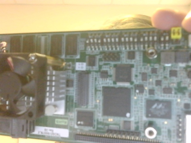

    I thought I had the settings right.  I took a picture in case I am just confused about orientation or something.
    From L to R: (off on on off) (on on on on) (on on on off) (off on on on) (off on)
    I also experimented with SW3 (tried about half the 16 possibilities) and I could not find a setting that gave me 0x1809 (per this http://e2e.ti.com/support/dsp/c6000_multi-core_dsps/f/639/t/191930.aspx).  Most settings gave me the same 0x1080B.
    Does the above picture look right?  Thanks
  • James,
    I think you may halt the CPU too soon and the device is still in IBL which is I2C boot mode. The section 9.2 in "C:\ti\mcsdk_2_01_02_05\tools\boot_loader\examples\pcie\docs\README.pdf" file mentions the role of IBL in PCIe boot mode.
    If you stop halting and CPU and let it run for another several seconds (such as 10sec) and then halt it again, could you check if the value in DEVSTAT (0x02620020) has been changed to 0x10809 please?
    May I ask if you did the testing with EVM card inserted into the PCIe slot without external power supply to the EVM please (The PCIe slot will power up the EVM)?
    Could you please check the PCIE_SERDES_STS (0x0262015C) to see if bit 0 is 1 (indicating the PCIe PLL clock has been locked) please?
    The PCIe link will not be established if the PLL could not be locked correctly.
    And please check PCIe DEBUG0 (0x21801728) register to see if bits[4:0] is 0x11, which means the PCIe link is up between EP and RC (host).

  • James,
    It looks like the IBL update was not successful, otherwise the PC register should show the address of L2 SRAM.
    May I ask if you use "i2crom_0x51_c6678_le.bin" file with the EEPROM writer for the IBL update please?
    I noticed that sometimes it was not working using "i2crom_0x51_c6678_le.dat" file for the IBL update. So please give a try on ".bin" file instead.
    And please make sure when you do the IBL update, the EVM should be programmed in no-boot mode. That is:
    switch pin  1   2   3   4
    SW3:        off on on on
    After programming the IBL, you can switch SW3 back to PCIe boot mode for the testing.
    switch pin  1   2   3   4
    SW3:        off on on off
    Hope it helps.
