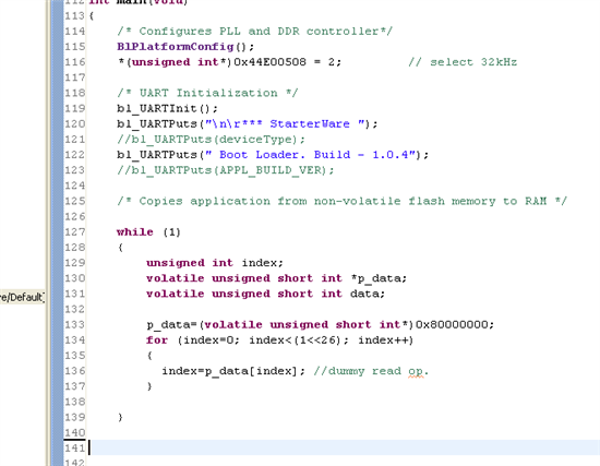

Same behaviour when reading (instead of writing):
while (1)
    unsigned int index;
    volatile unsigned short int *p_data;
    volatile unsigned short int data;
    p_data=(volatile unsigned short int*)0x80000000;
    for (index=0; index<(1<<26); index++)
      dummy=p_data[index]; //dummy read op.
Time between CS# pulses (OE# is differential and I've no hi speed differential probes) is about 820ns.
There is no signal integrity issue: all ram write&read tests perform nicely.
Hints to speedup?
