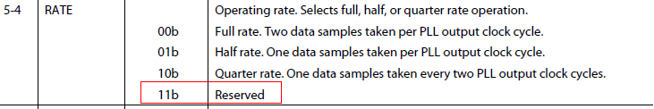

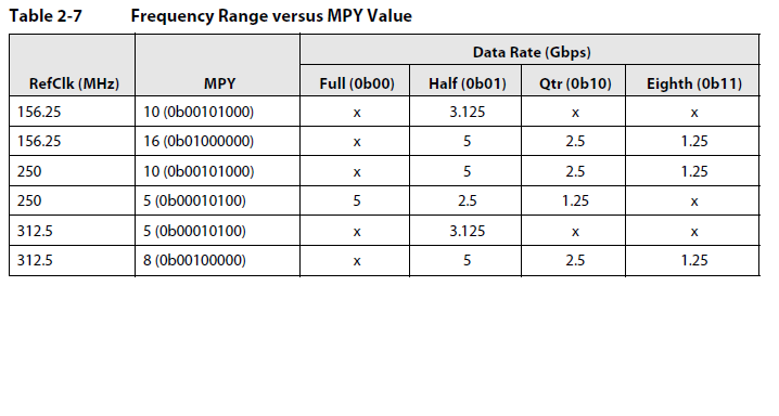

          Now I have some other problem confused me,first, if the SP_ERR_STAT show that the port is OK, can I say that the physic connection is OK?
    second, in my test,if I configure the speed as 5.0Gbps, both the DSP and FPGA can be initialized, and the PORT is ok,but if I configure the speed as 1.25Gbps by change the code as bellow, the FPGA initialize state line become unstable, it changes from '1' to '0'   randomly, which is the reason for this ,should I configue something else?
    change #define SRIO_DEFAULT_TEST_SPEED 5.0 to #define SRIO_DEFAULT_TEST_SPEED 1.25
    I'll waiting for your reply ,sincerely yours黄成章!!!~_~
  • "Port OK" is one of the key flag, but it does not indicate all right. It is possible that "Port OK" is set, but there are still other error. The "SRIO_debug.c" provides functions to check all status/flags.
    For 1.25GHz issue, firstly, please check if the Serdes PLL is configured as 312.5MHz*8/2=1.25GHz. In our early example, it may be configured as  312.5MHz*16/1=1.25GHz, which is incorrect, because the Serdes PLL output must be between 1.5625 and 3.125, and, the link rate scale should be used to achieve final expected link rate. Attached please find updated code for Serdes configuration:

    after the code above executed, the value of linkRateScale is 0x11, and I find the value seemly  undefined according to the document(SPRUGW1A) on page 43 and page 46,on page 43 ,it said that if the ratescale is 0x03, it is eighth rate,while it is reserved for 0x03 on page 46,this confused me ,how could I set the serdes PLL? I think I should just configue the "serdes_cfg->CFG_PLL.MPY = 8" and set the RATE bit in "serdesRegs->link[i].CFGRX" or "serdesRegs->link[i].CFGTX" as 0x11 according to the tabel 2-7 on page 43 in SRUGW1A, but it seems that it is wrong if I do that, it seems that it can't run as 1.25Gbps on 6678EVM
    because of the refclock is 312.5MHz, does it right?
  • You were looking at old document, below is the updated information in the new version of the document (sprugw1b):
    00 Full Rate Four data samples taken per PLL output clock cycle
    01 Half Rate Two data sample taken per PLL output clock cycle
    10 Quarter Rate One data sample taken per PLL output clock cycle
    11 Eighth Rate One data sample taken every two PLL output clock cycles
