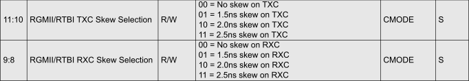

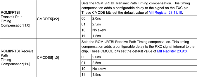

  • Hi -DK-,
    Thank you for your reply.
    I checked the VSC8211 datasheet. VSC8211 seems to support the internal delay mode by registers configuration or externally-strapped configuration.
    "Bits 23.11:10 specify the amount of clock delay added to the TX_CLK line inside the VSC8211 when using an RGMII or RTBI interface."
    "Bits 23.9:8 specify the amount of clock delay added to the RX_CLK line inside the VSC8211 when using an RGMII or RTBI interface."
    "The default values of these bits are specified by the RGMII Skew bits in the CMODE hardware configuration."
    Can you guess that these indicate the internal delay mode required by AM335x?
    I will suggest to the customer using a PHY supporting the internal delay mode if VSC8211 does not support it.
    Daisuke

  • From what you posted here, it appears that this PHY does support Internal Delay via both software and hardware (assuming that CMODE5 refers to a series of pins on the device). Because each board design is different, this particular solution would need to be "tuned" to determine the ideal delay. Typically, the inserted delay needs to be ~1.8ns for designs that have length-matched transmit/receive:data traces, so I'd start with '00' (2ns) and verify sufficient timing via direct observation with a scope.

  • Hi -DK-,
    I have an additional question.
    I want to know whether VSC8211 can be used for EMAC boot.
    Please see the 26.1.8.4.1 on TRM(SPRUH73L). In Device Initialization, the ROM code assumes that the Ethernet PHY with the lowest MDIO address (0-31) is connected to CPGMAC port 1.
    The registers in the address 16-31 are "Vendor Specific" which is specified in the IEEE802.3u clause 22. Does the ROM code not configure these registers?
    Daisuke

    Based on the information you've provided here, this PHY should support EMAC boot if HW strapped for appropriate internal delays. That said, I'm not familiar with this PHY so ultimate suitability responsibility lies with the customer.

    No, the ROM does not configure these registers. This is why the Internal Delay must be HW strapped rather than SW programmed to support boot. After boot, these registers can be changed via standard MDIO commands the to PHY.
