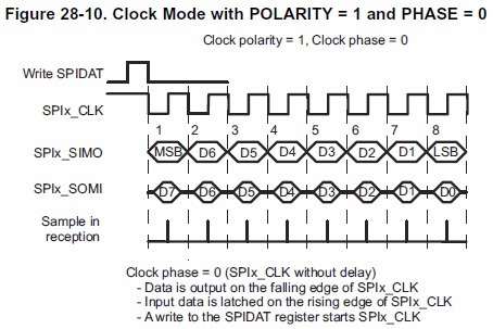

    4) The ADXL345 datasheet would suggest that the POLARITY=1 and PHASE=0. The config is then:
    SPIConfigClkFormat(SOC_SPI_0_REGS,
                        SPI_CLK_POL_HIGH|SPI_CLK_INPHASE,
                        dataFormat);

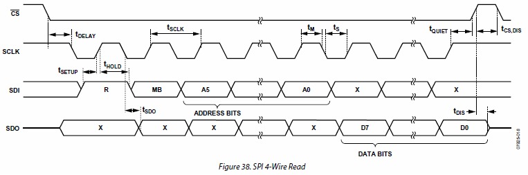

  • Note much more to add. I'd try all four combinations of Polarity and Phase. The ADXL345 SPI timing diagram
    and the C6748 Polarity =1 / Phase = 0 diagram
    The ADXL345 diagram is admittedly hard to understand with nothing lining up. The C6748 diagram is far too idealized. But in both cases, data is stable on the rising edge of SCLK and SCLK is high on idle.
