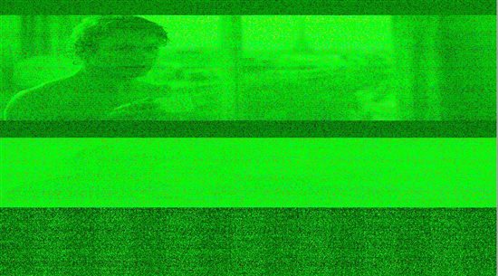

So we want to capture the interlaced video field data.
Our question is:
How to modify the driver to capture field data so we can use the DEI module(omx_mdeiscaler in pipeline)?
We changed some code and found the bottom field is lost.
