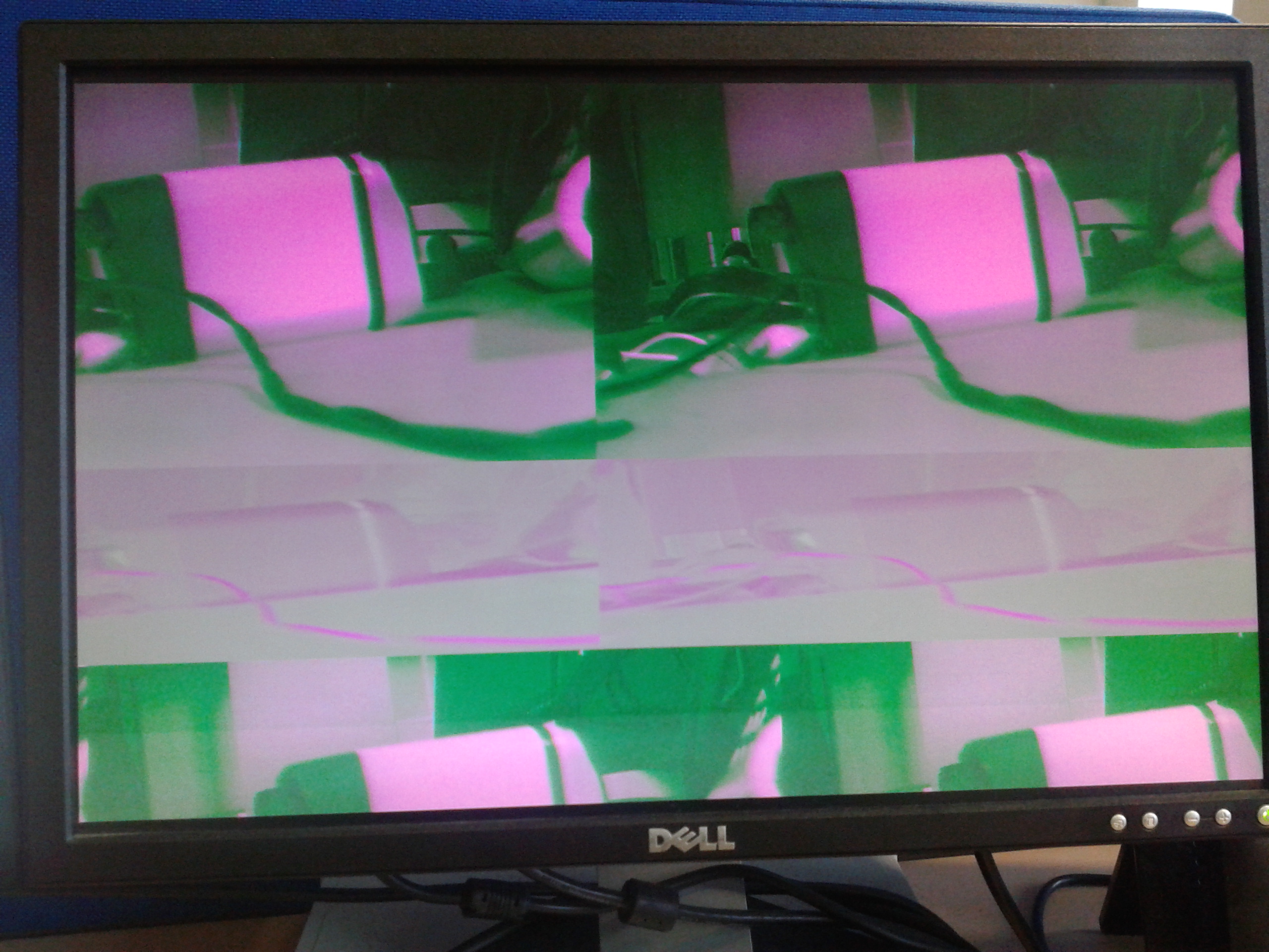

If I use the second output port on the DEI to output YUV420SemiPlanar to the VFDC component I get the following image:
It works fine if I use the first output from the DEI, which is set up to output YCbYCr. I have made sure that the buffer sizes, frame width, height and stride settings are correct in the DEI and VFDC settings and that the buffers that are shared via OMX_UseBuffer are set up to use the correct buffers. I have also made sure that the call to IL_ClientConnectComponents is connecting the correct components and output ports to the correct components and input ports.
Does the DEI component not support output of YUV420SemiPlanar on both outputs?
What is causing this issue with the image?
    If you connect the output port to the VFDC component you should connect the output which is providing 422 not 420SP. The VFDC component supports 422 input.
    No.
    Formats doesn't match. Please connect the output ports of DEI component correct.

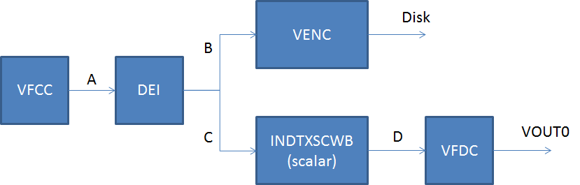

    The problem is that I need to get the formats correct for input to each component. The above was a test. What I really need to end up with is the following:
    The reason for having 2 scalars (one of them is the DEI) is that I need independent image cropping.
    The configuration is as follows:
    A: YUV420SemiPlanar
    B: YUV420SemiPlanar
    C: YUV420SemiPlanar
    D: YCbYCr
    VOUT is configured for yuv422spuv
    But this configuration leads to the image shown in my previous post.
    The video input is 1080p.
    Can the INDTXSCWB scalar take YCbYCr as input?
    Steven

    We need the additional scaler because we want the output to the VFDC to be cropped but the output to the VENC not to be cropped. The DEI does not support independent cropping.
    I understand the data flow between components. What I dont understand is the I/O requirements of each component because the user guide is not very clear on this. I dont even know if what I am attempting to do is possible!
    I will go through the user guide again and compile a list of what I/O formats it looks like each component supports and I will post them here. I would appreciate it if you could respond to this to let me know if what I am attempting to do can be done in this way.
    I could also try using two DEI Components instead of a DEI and a scaler component.  How do I create a second DEI Component? Will doing this just give me a handle to the first DEI?

    I have been successful in getting 2 DEI components running on the DM8148. The YUV420 output from DEI1 feeds the input to both DEI2 and VENC. This has been done using the FillBufferDone message from DEI1 when it is sending data to VENC by sending an ETB message. The message is also sent to DEI2. Requests from DEI2 to FillThisBuffer are ignored.
