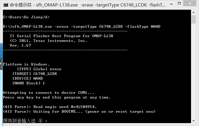

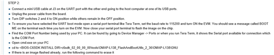

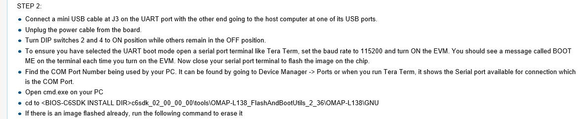

Hi, I want to flash my LCDK6748 (NAND).I follow the step following:

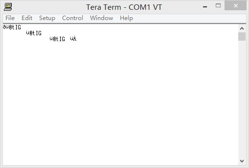

everytime when I use Tera Term ,set the baud rate to 115200 and turn ON the EVM, I never got the BOOTME,but as follow:
of course I changed the BOOTMODE the switch2 and 4 are ON and Others are OFF. It's the UART2 MODE.
So of course I can not erase the NAND when I use the commond:

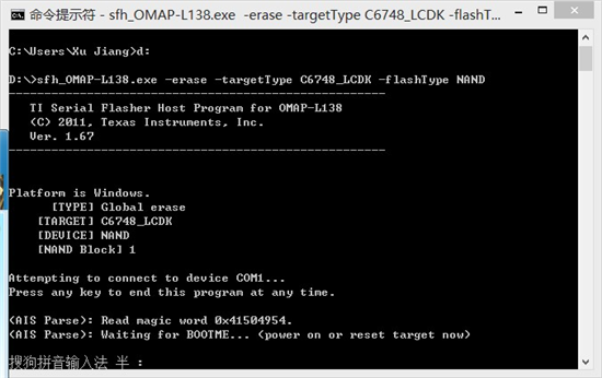

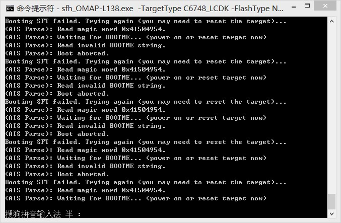

sfh_OMAP-L138.exe -erase -targetType C6748_LCDK -flashType NAND -p <COM_Port_Number>
the result is as follow:
 when I reset ,nothing happened. Do you know the problem?
