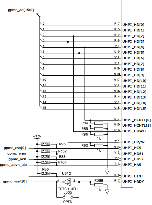

For correct operation, must UHPI_HAS during UHPI_HSTROBE inactive cycle be kept High?
Our customer uses C6746 with AM3359. UHPI_HAS connects to GPMC_ADVn_ALE. UHPI_HAS during UHPI_HSTROBE inactive cycle is not kept High.
The write access after the read access fails then some data buses show the middle level voltages.

    The high-level connections between the HPI and the GPMC are as follows:

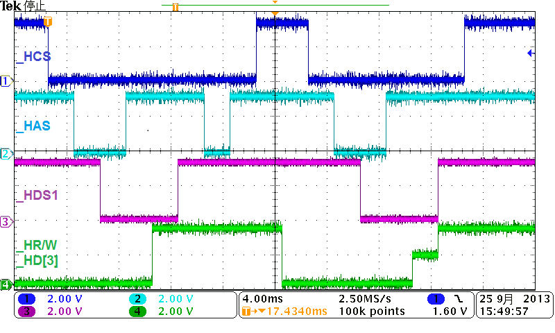

    When GPMC is used, the access of 2nd half-word fails. The trace of the access is as follows:
    When GPMC is used and the access of 2nd half-word is performed two times, the access can succeed.

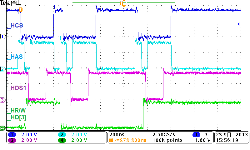

    To succeed, the first access in two times writes 0x0000 (UHPI_HR/W is Low). The trace of the access is as follows:

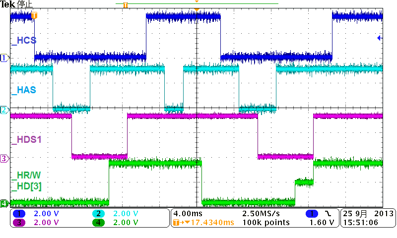

    When GPIO is used and UHPI_HAS during UHPI_HSTROBE inactive cycle (UHPI_HCS is High) is not kept High, the access of 2nd half-word fails.

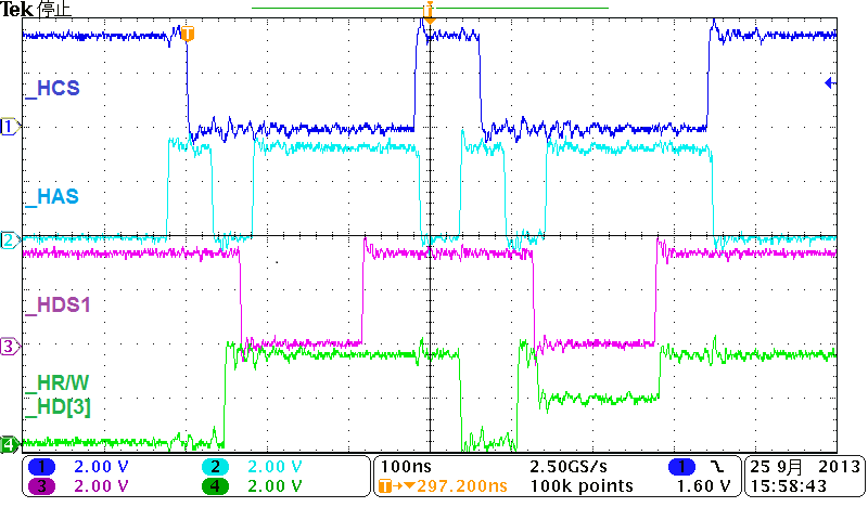

    When GPIO is used and UHPI_HAS during UHPI_HSTROBE inactive cycle (UHPI_HCS is Low) is not kept High, the access of 2nd half-word fails.

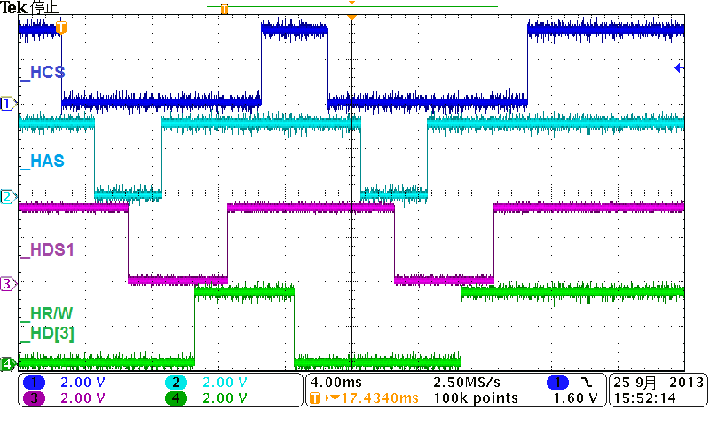

    When GPIO is used and UHPI_HAS during UHPI_HSTROBE inactive cycle is kept High, the access succeeds.

    For correct operation, if UHPI_HAS during UHPI_HSTROBE inactive cycle must be kept High, for UHPI_HAS the signal which GPMC_ADVn_ALE and GPMC_CSn[0] were passed through an external OR-gate will be used.

    After digging deeper into the design, it seems like HAS is not gated by HCS. So HAS has to be kept high as when HSTROBE is inactive as in the last plot in your post.
    Another issue I see in the plots is that the HR/W signal does not seem to meet HPI setup timing requirement.

    The HAS signal will be external-gated by HCS.
    The HR/W signal setup time before the UHPI_HAS Low is needed least 5ns. It seems to be met.
