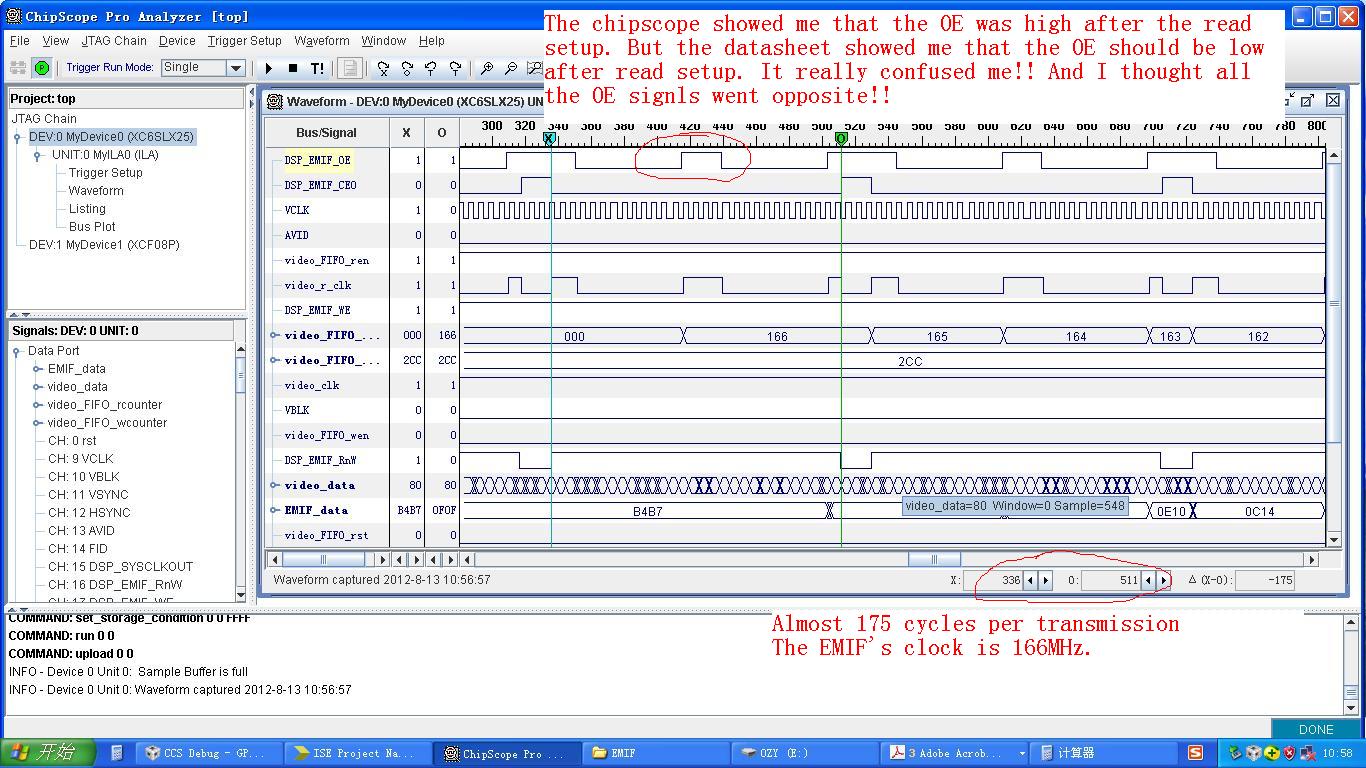

When I tried to transfer data from FPGA to C6678 through EMIF16 interface, I wanted to decrease the read setup, read strobe and read hold values to increase the throughput.
I used the code below to configure the EMIF's A0CR register

But I got the EMIF timing in the Chipscope, it showed me that didn't happen.
The problems were that
1. The FPGA send the data to C6678 and C6678 read the data. I had got the right data. But the OE signals in EMIF were completely opposite to the description in the EMIF datasheet.
2. I had changed the values in A0CR to decrease the setip and hold cycles to increase the throughout. But the actual timing showed me that didn't happen!!!

  • Hi Feng,
    The OE is a low true output. It's difficult to make out the details of the picture that you sent but it appears that the cursor is bracketing two EMIF accesses. You have circled the OE going high between the first access and the second access. Note that there is no guarantee that the CS will go high between two accesses. If accesses are close together the CS may stay low until all accesses are complete.
    Regards, Bill

    1. I captured the OE signal and the results howed me that the OE went high after the read setup. See the picture below
    In the picture above, you can see when the RnW signal goes high (it means that it's in reading) the OE
    signal will go low and high and then low again. So I think the OE goes opposite to the description in datasheet.
    And the more details I describe in the picture above will show you what I think.
    2. I meet another big question.
    The problem was that the delay between two EMIF reading access was too high, almost 24 EMIF cycles!!!
    And the problem was completely like this guy's decription in http://e2e.ti.com/support/dsp/c6000_multi-core_dsps/f/639/t/192245.aspx. I had got the same EMIF reading timing with this guy's. But in the posts of that thread, I can't find the final solution.

  • Hi Feng,
    Your image is showing two separate accesses to the EMIF interface. Do you have the width set up as 16bits or 8bits? I suspect that you are accessing the EMIF with a read type that is of a greater width then your EMIF bus width. When you attempt to do the read, the EMIF interface will automatically detect that it needs to access memory twice to fulfill the entire read. For example if your software attempts to read a 32bit value and you have your EMIF bus configured as 16bits, the EMIF interface will force two reads of 16bits each.  Your image shows the CS going low followed by the OE going low for the first read, the OE going high between reads and then the OE going low again for the second read. When the OE is high, no read is taking place.
    The thread that you referenced has some detailed information concerning increasing the throughput on the EMIF interface. Note that the EMIF was not intended to be a high speed interface for streaming data. If you need to stream data into the part at high speeds then you may want to consider using the SRIO interface. On the second page of the reference thread the following post describes how to configure the EMIF for the fastest possible throughput.
    Even though this is an older thread, I wanted to post some recent information.
    In some cases of use of the EMIF16, we have found that an unused internal feature can cause unintended delays between some EMIF16 accesses. This feature can be disabled by setting the msb of 0x20C00008 to 1. I recommend setting this in all cases for the C6678, and placing it near the top of your main() function.
    *(Uint32*)0x20C00008 |= 0x80000000;  // Disable unused internal EMIF feature
    Regards, Bill
