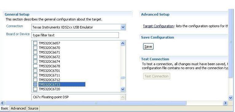

We upgraded to CCS v5.3 and emulation package 5.1.275.0. Now the C6713 appears in the list, but we always get an error (#2084) when trying to start a debug session. We've found a post related to this problem. Is there any fix?
Daniel

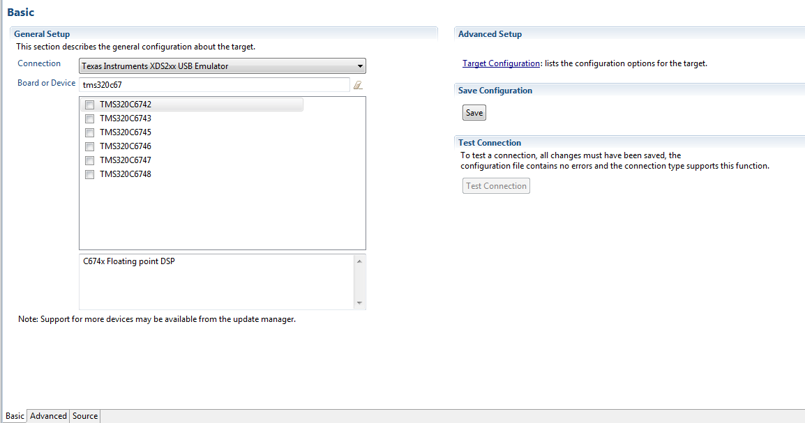

Hi Daniel,
According to TIs Wiki it is not supported:
It's a shame that TI doesn't offer affordable solutions for the older processors (I'm using a C6726B myself)!
