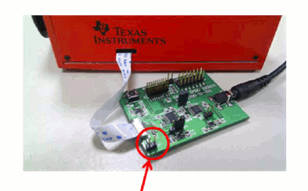

  • Hello
    You can confirm the boot media is correct,
    Because I also experienced the same problem, uart output CCCC
    1. no insert SD Card or format
    2. no short the pin
    in my case, hope to help you.
