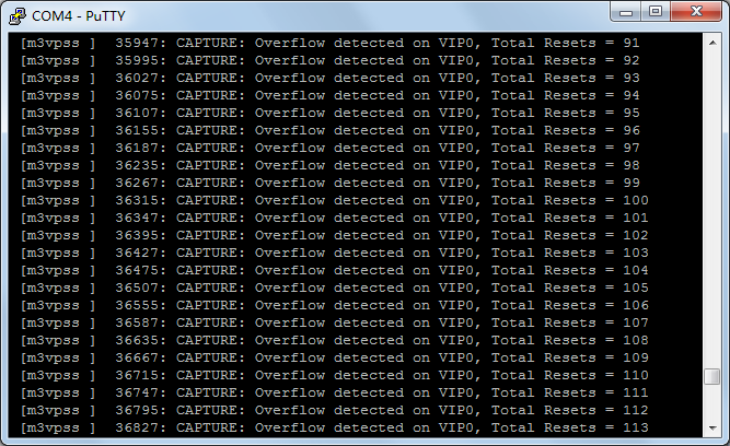

Capture encode problem with DVRRDK 04.00.00.03
Other Parts Discussed in Thread: TVP7002
I use the DVRRDK 04.00.00.3 on a EVM8168 plateform.
I use the Link API to create custom application that can capture video and encode it in h264.
CAPT (1Ch 720p50) --> IPCM3OUT(VPSS) --> IPCM3IN(VID) --> ENC --> IPC BIT OUT RTOS --> IPC BIT IN HLOS --> file.
The application works well but int the resulting file, I have a problem about the image sequence. This means that every 5/6 pictures, there is an old picture.
It seems that the buffers are not properly cleaned and that are registered in the new h264 file.
This problem is about the configuration of the encoder or the capture configuration ?

void capture_encode_start(Config_struct *Pt_Conf)
    CaptureLink_CreateParams    capturePrm;
    IpcLink_CreateParams        ipcOutVpssPrm;
    IpcLink_CreateParams        ipcInVideoPrm;
    EncLink_CreateParams        encPrm;
    IpcBitsOutLinkRTOS_CreateParams   ipcBitsOutVideoPrm;
    IpcBitsInLinkHLOS_CreateParams    ipcBitsInHostPrm;
    CaptureLink_VipInstParams *pCaptureInstPrm = NULL;
    CaptureLink_OutParams     *pCaptureOutPrm = NULL;
    UInt32 i/*, status*/;
    printf("NME :  capture_encode_start\n");
    _captureId           = SYSTEM_LINK_ID_CAPTURE;
    _encId                = SYSTEM_LINK_ID_VENC_0;
    _ipcBitsOutVpssId     = SYSTEM_VPSS_LINK_ID_IPC_OUT_M3_0;
    _ipcBitsInVideoId     = SYSTEM_VIDEO_LINK_ID_IPC_IN_M3_0;
    _ipcBitsOutVideoId    = SYSTEM_VIDEO_LINK_ID_IPC_BITS_OUT_0;
    _ipcBitsInHostId       = SYSTEM_HOST_LINK_ID_IPC_BITS_IN_0;

    CHAINS_INIT_STRUCT(CaptureLink_CreateParams, capturePrm);
    CHAINS_INIT_STRUCT(IpcLink_CreateParams, ipcOutVpssPrm);
    CHAINS_INIT_STRUCT(IpcLink_CreateParams, ipcInVideoPrm);
    CHAINS_INIT_STRUCT(EncLink_CreateParams, encPrm);
    CHAINS_INIT_STRUCT(IpcBitsOutLinkRTOS_CreateParams, ipcBitsOutVideoPrm);
    CHAINS_INIT_STRUCT(IpcBitsInLinkHLOS_CreateParams, ipcBitsInHostPrm);
    CaptureLink_CreateParams_Init(&capturePrm);
    capturePrm.numVipInst    = 1; /* on utilise qu'un seul VIP inst */
    capturePrm.outQueParams[0].nextLink = _ipcBitsOutVpssId;
    // capturePrm.tilerEnable              = FALSE;
    // capturePrm.enableSdCrop             = FALSE;
    // capturePrm.isPalMode                = FALSE;
    // capturePrm.numBufsPerCh             = 4;
    // capturePrm.numExtraBufs             = 0;
    // capturePrm.maxBlindAreasPerCh       = 0;
    // capturePrm.doCropInCapture          = FALSE;
    printf("NME :  init pCaptureInstPrm\n");
    for(vipInstId=0; vipInstId< capturePrm.numVipInst ; vipInstId++)
        pCaptureInstPrm                     = &capturePrm.vipInst[vipInstId];
        pCaptureInstPrm->vipInstId          = (SYSTEM_CAPTURE_INST_VIP0_PORTA+vipInstId) % SYSTEM_CAPTURE_INST_MAX;
        pCaptureInstPrm->videoDecoderId     = 0/*SYSTEM_DEVICE_VID_DEC_TVP5158_DRV*/;
        pCaptureInstPrm->inDataFormat       = SYSTEM_DF_YUV422P;
        pCaptureInstPrm->standard           = Pt_Conf->res0; /* resolution est frequence de la video en entrée */
        pCaptureInstPrm->numOutput          = 1;
        pCaptureInstPrm->numChPerOutput     = 1;
        pCaptureOutPrm                      = &pCaptureInstPrm->outParams[0];
        pCaptureOutPrm->dataFormat          = SYSTEM_DF_YUV420SP_UV;
        //pCaptureOutPrm->dataFormat          = SYSTEM_DF_YUV422I_UYVY;
        //pCaptureOutPrm->dataFormat          = SYSTEM_DF_YUV422P;
        pCaptureOutPrm->scEnable            = FALSE; /* desativation du module de scale */
        pCaptureOutPrm->scOutWidth          = Pt_Conf->width[vipInstId];
        pCaptureOutPrm->scOutHeight         = Pt_Conf->height[vipInstId];
        pCaptureOutPrm->outQueId            = 0;
        switch(pCaptureInstPrm->standard)
            case VSYS_STD_720P_60:
            case VSYS_STD_720P_50:
                pCaptureInstPrm->videoIfMode        = SYSTEM_CAPT_VIDEO_IF_MODE_16BIT;
                pCaptureInstPrm->inScanFormat       = SYSTEM_SF_PROGRESSIVE;
                pCaptureInstPrm->videoCaptureMode   = SYSTEM_CAPT_VIDEO_CAPTURE_MODE_SINGLE_CH_NON_MUX_EMBEDDED_SYNC;
                break;
            default:
                pCaptureInstPrm->standard           = VSYS_STD_720P_50;
                pCaptureInstPrm->inDataFormat       = SYSTEM_DF_YUV422SP_UV;
                break;
    ipcOutVpssPrm.inQueParams.prevLinkId    = _captureId;
    ipcOutVpssPrm.inQueParams.prevLinkQueId = 0;
    ipcOutVpssPrm.numOutQue                 = 1;
    ipcOutVpssPrm.notifyNextLink            = TRUE;
    ipcOutVpssPrm.notifyPrevLink            = TRUE;
    ipcOutVpssPrm.noNotifyMode              = FALSE;
    ipcOutVpssPrm.inputFrameRate            = (UInt32)((double)Pt_Conf->framerate[0] / (double)IPC_FRAMERATE);
    ipcOutVpssPrm.outputFrameRate           = (UInt32)((double)Pt_Conf->framerate[0] / (double)IPC_FRAMERATE);
    ipcOutVpssPrm.outQueParams[0].nextLink  = _ipcBitsInVideoId;
    ipcOutVpssPrm.numChPerOutQue[0]  = 1;

    Il have multiple "CAPTURE: Overflow detectedon VIP" and i have anything data encoded.

     [m3vpss ]  19521: CAPTURE: Dynamic resolution change: width: 1280, height: 720!
     [m3video] 19521:!ERROR!:ENCLINK::links_m3video/iva_enc/encLink_h264.c:[232]::INTERNAL ERROR:-1
     [m3video] ALGCONTROL FAILED:CMD:1
     [m3vpss ]  19521: CAPTURE: Overflow detected on VIP0, Total Resets = 1
     [m3video] ERROR: XDM_UNSUPPORTEDPARAM = 14,
     [m3video] ERROR: XDM_FATALERROR = 15
     [m3video] ERROR: IH264ENC_UNSUPPORTED_VIDENC2DYNAMICPARAMS = 30,
     [m3video] 19522:WARN
     [m3video]  ENCLINK: ERROR in Run time parameters changes, Extended Error code:1073790976
     [m3video] 19522:!ERROR!:ENCLINK::links_m3video/iva_enc/encLink_h264.c:[455]::INTERNAL ERROR:-1
     [m3video] ALGPROCESS FAILED
     [m3video] Number of Entries in Process List : 1
     [m3video] Extended error for entry 0 : 0x4000c000
     [m3video] ENCLINK:ERROR in Enclink_h264EncodeFrameBatch.Status[-1] for IVAHD_0
     [m3video] ENC : IVAHDID : 0 ENCLINK:ERROR in EncLink_SubmitBatch.Status[-1]
     [m3vpss ]  20129: CAPTURE: Overflow detected on VIP0, Total Resets = 2
     [m3vpss ]  20561: CAPTURE: Overflow detected on VIP0, Total Resets = 3
     [m3vpss ]  20753: CAPTURE: Overflow detected on VIP0, Total Resets = 4
     [m3vpss ]  21185: CAPTURE: Overflow detected on VIP0, Total Resets = 5
     [m3vpss ]  21361: CAPTURE: Overflow detected on VIP0, Total Resets = 6
     [m3vpss ]  21793: CAPTURE: Overflow detected on VIP0, Total Resets = 7
     [m3vpss ]  21921: CAPTURE: Overflow detected on VIP0, Total Resets = 8
     [m3vpss ]  22593: CAPTURE: Overflow detected on VIP0, Total Resets = 9
     [m3vpss ]  23025: CAPTURE: Overflow detected on VIP0, Total Resets = 10
     [m3vpss ]  23169: CAPTURE: Overflow detected on VIP0, Total Resets = 11
     [m3vpss ]  23601: CAPTURE: Overflow detected on VIP0, Total Resets = 12
     [m3vpss ]  23761: CAPTURE: Overflow detected on VIP0, Total Resets = 13
     [m3vpss ]  24193: CAPTURE: Overflow detected on VIP0, Total Resets = 14
     [m3vpss ]  24401: CAPTURE: Overflow detected on VIP0, Total Resets = 15
     [m3vpss ]  24833: CAPTURE: Overflow detected on VIP0, Total Resets = 16
     [m3vpss ]  24993: CAPTURE: Overflow detected on VIP0, Total Resets = 17
     [m3vpss ]  25425: CAPTURE: Overflow detected on VIP0, Total Resets = 18
     [m3vpss ]  25569: CAPTURE: Overflow detected on VIP0, Total Resets = 19
     [m3vpss ]  26161: CAPTURE: Overflow detected on VIP0, Total Resets = 20
     [m3vpss ]  26657: CAPTURE: Overflow detected on VIP0, Total Resets = 21
     [m3vpss ]  26801: CAPTURE: Overflow detected on VIP0, Total Resets = 22
     [m3vpss ]  27233: CAPTURE: Overflow detected on VIP0, Total Resets = 23
     [m3vpss ]  27393: CAPTURE: Overflow detected on VIP0, Total Resets = 24
     [m3vpss ]  27825: CAPTURE: Overflow detected on VIP0, Total Resets = 25
     [m3vpss ]  27969: CAPTURE: Overflow detected on VIP0, Total Resets = 26
     [m3vpss ]  28641: CAPTURE: Overflow detected on VIP0, Total Resets = 27
     [m3vpss ]  29073: CAPTURE: Overflow detected on VIP0, Total Resets = 28
     [m3vpss ]  29201: CAPTURE: Overflow detected on VIP0, Total Resets = 29
     [m3vpss ]  29633: CAPTURE: Overflow detected on VIP0, Total Resets = 30
     [m3vpss ]  29809: CAPTURE: Overflow detected on VIP0, Total Resets = 31
     [m3vpss ]  30241: CAPTURE: Overflow detected on VIP0, Total Resets = 32
     [m3vpss ]  30369: CAPTURE: Overflow detected on VIP0, Total Resets = 33
     [m3vpss ]  30865: CAPTURE: Overflow detected on VIP0, Total Resets = 34
     [m3vpss ]  31041: CAPTURE: Overflow detected on VIP0, Total Resets = 35
     [m3vpss ]  31473: CAPTURE: Overflow detected on VIP0, Total Resets = 36
     [m3vpss ]  31601: CAPTURE: Overflow detected on VIP0, Total Resets = 37
     [m3vpss ]  32033: CAPTURE: Overflow detected on VIP0, Total Resets = 38
     [m3vpss ]  32209: CAPTURE: Overflow detected on VIP0, Total Resets = 39
     [m3vpss ]  32641: CAPTURE: Overflow detected on VIP0, Total Resets = 40
     [m3vpss ]  32833: CAPTURE: Overflow detected on VIP0, Total Resets = 41
     [m3vpss ]  33265: CAPTURE: Overflow detected on VIP0, Total Resets = 42
     [m3vpss ]  33441: CAPTURE: Overflow detected on VIP0, Total Resets = 43
     [m3vpss ]  33873: CAPTURE: Overflow detected on VIP0, Total Resets = 44
     [m3vpss ]  34001: CAPTURE: Overflow detected on VIP0, Total Resets = 45
     [m3vpss ]  34609: CAPTURE: Overflow detected on VIP0, Total Resets = 46
     [m3vpss ]  35105: CAPTURE: Overflow detected on VIP0, Total Resets = 47
     [m3vpss ]  35233: CAPTURE: Overflow detected on VIP0, Total Resets = 48
     [m3vpss ]  35681: CAPTURE: Overflow detected on VIP0, Total Resets = 49
     [m3vpss ]  35841: CAPTURE: Overflow detected on VIP0, Total Resets = 50
     [m3vpss ]  36273: CAPTURE: Overflow detected on VIP0, Total Resets = 51
     [m3vpss ]  36401: CAPTURE: Overflow detected on VIP0, Total Resets = 52
     [m3vpss ]  36913: CAPTURE: Overflow detected on VIP0, Total Resets = 53
     [m3vpss ]  37073: CAPTURE: Overflow detected on VIP0, Total Resets = 54
     [m3vpss ]  37505: CAPTURE: Overflow detected on VIP0, Total Resets = 55
     [m3vpss ]  37649: CAPTURE: Overflow detected on VIP0, Total Resets = 56
     [m3vpss ]  38081: CAPTURE: Overflow detected on VIP0, Total Resets = 57
     [m3vpss ]  38241: CAPTURE: Overflow detected on VIP0, Total Resets = 58
     [m3vpss ]  38673: CAPTURE: Overflow detected on VIP0, Total Resets = 59
     [m3vpss ]  38881: CAPTURE: Overflow detected on VIP0, Total Resets = 60
     [m3vpss ]  39313: CAPTURE: Overflow detected on VIP0, Total Resets = 61
     [m3vpss ]  39473: CAPTURE: Overflow detected on VIP0, Total Resets = 62

     [m3vpss ]  48818: CAPTURE: Fields = 722 (fps = 24, CPU Load = 0)
     [m3vpss ]  48818: CAPTURE: Num Resets = 89 (Avg 7 ms per reset)

  • There is something seriously wrong with your build setup. The line PLATFORM: UNKNOWN CPU detected, defaulting to VPS_PLATFORM_CPU_REV_2_0 should never be printed. Can you check you are doing clean rebuild of all components including HDVPSS drivers for 816x platform.
  • Can you share your kernel boot up logs. I want to check if you are using PG 2.1 silicon in which case the warning from HDVPSS is expected and you can disregard it.
    For VIP reset error check the signal from external video decoder is stable. Also confirm you wanted to configure 16-bit non mux embedded sync as the required configuration.The capture FPS is wrong. Capture only shows 25-28 fps but I think your source is 50 fps.
    The encoder target fps can be set anytime after create. THe error indicates the encoder targetFps is set to some invalid value like 0. Print all the static and dynamic params of encoder share them
    In the boot log, the OMAP chip identify is TI8168 2.1. (see log attached).

    Now, with the good uboot firmware, the problem in the capture stream is that is missing image !!!
    I don't understand where is the problem.
    This is the log of the last test I have done and the code.

        I have read your posts and found they are informative.  I also want to do the TVP7002 YUV component capture within the McfW of DVRRDK, based on my EVM8168 + Catalog Daughtercard.  I tired to follow your steps and instructions.
        Though I could successfully build the program you provided and run the tvp7002 initial script, there seems to be something wrong with my project:  It continuously cast "CAPTURE: Overflow detected on VIP0" once I tried to run the case.
         I have also copied your tvp7002 initial script and run it before this program.  A verified 1280x720p50 YUV signal is also provided to the catalog daughtcard.  I have no idea with this issue.  Could you give me a hand?

  • Hi Naroah,
    Sorry to the late  !!
    I don't now why they are overflow on VIP and I have actually the same error on 1080p30. I search...
    If I found a solution, I send it to you.
    Sorry
  • Are you doing inline scaling and upscale the input video? In this case, there could be overflow?
    If not, what is your input information to the VIP? Is it discrete sync or embedded sync? In case of discrete sync, can you check sync polarity is correctly configured? Even clock edge polarity is correct?
    Rgds,
    Brijesh
