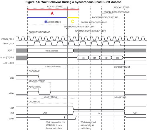

AM335x GPMC WAIT Pin Monitoring Control
WAIT monitored as active freezes the CYCLETIME counter. Does the CYCLETIME counter mean the RDCYCLETIME or the WRCYCLETIME counter?
In the synchronous read, does the asserted WAIT pin extend the current access time before the timing which depends on the programmed WAITMONITORINGTIME value?
Similarly, does the asserted WAIT pin extend the current access time between the timing which depends on the programmed WAITMONITORINGTIME value and the RDACCESSTIME completion?
During the extended current access, all control signals are kept in their current state.
