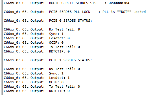

  • hi Eric,
    I am still have this issue.
    By the way: I am using the Boot Switches for SPI regarding to http://processors.wiki.ti.com/index.php/TMDSEVM6657L_EVM_Hardware_Setup#Boot_Mode_Dip_Switch_Settings on my TMDSEVM6657LS.
    The function pcieSerdesCfg() is already part of the PCIE_example and is executed successfully. As far as I understand this function enables the PCIE PLL.

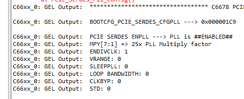

    This is going well, as my boot.gel reports me:
    This PLL now is enabled, but in the next step it does not lock:
    Could it be a problem with some "main PLL/reference clock". I found this post: http://e2e.ti.com/support/dsp/c6000_multi-core_dsps/f/639/p/307521/1075609.aspx, but I cannot map their solution on my problem.
    I checked different bootmode switch settings (see SPRS814A, 2.5.3), but just with "000" I could complete the boot process. Other switch settings will stuck during boot and PCIE PLL is not locked as well.

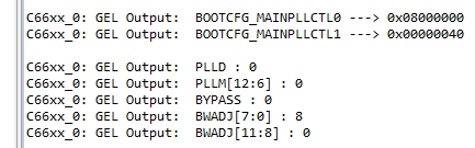

    When checking MAINPLLCTL0 I found kind of surprising setting:
    Regarding to SPRS814A, 2.5.3 I expect PLLM=39 and not =0.
    But "no boot" bootmode as the same values for MAINPLLCTL0  and is able to lock the PCIE PLL.
    Any idea what is missing during SPI boot to lock the PCIE PLL?
    Thanks and Regards, Gregor

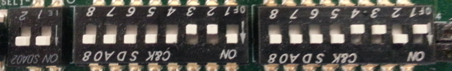

    I get following:
    SW5, pin 2 "ON": 0x0262_0020 = 0000_840D and 0x0262_015C = 00000200
    SW5, pin 2 "OFF": 0x0262_0020 = 0000_860D and 0x0262_015C = 00000200.
    I used pin setting:
    ROM SPI Boot8 (off, on, off, off, on, on, on, on) (on, on, off, on, on, on, on, on)
    As I understood, the 8 means that it is booted as PCIe RC. But I guess it does not matter, as we do not use PCIe boot mode.

  • On the back of the EVM, what is the PCB REV and PCA REV?
    For the SPI boot mode, can you try to set SW5, PIN 8 to "ON", so 0x262_0020 = 0x0000_60D, is PLL lock?
    Regards, Eric
  • hi Eric,
    SW5, pin 8 is already "ON" (see screen shot above). I turned it to "OFF", but still "0000_860D".
    PCB REV: 18-00132-02
    PCA REV: 17-00132-02
    Regards, Gregor
  • I didn't find your screenshoot. "ON" is logical "0", "OFF" is logical "1", attached picture for my setup to get "60D". My EVM is an older revision, I will try to find a new one with your revision.
    Regards, Eric
  • hi Eric,
    I confirm that I have the same switch settings and get "0000860D" as DEVSTAT.
    Do you have any idea, why my PCIESSMODE is set to RC (10)? I changed the setting of SW5, pin7&8, but could not see any influence on that.
    Gregor

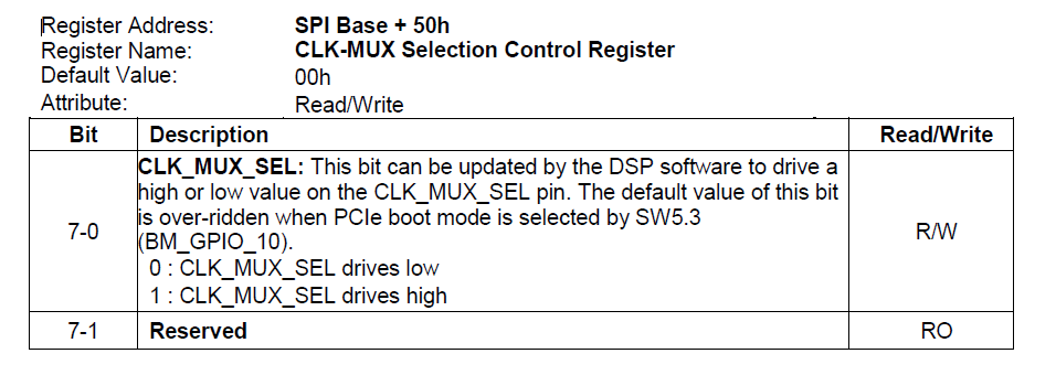

  • Gregor,
    - In SPI boot mode, DSP is expecting a PCIE reference clock externally (from AMC edge) instead of internally (from on-board oscilator), that is why PCIE PLL is not locked.
    - In no-boot mode, the DSP is expecting the PCIE reference clock internally, so you have PLL lock.
    - The clock selection is controlled by the FPGA code.
    I don't know how the PCIE reference clock used in your system. Is the FPGA (PCIE EP) use a local narrow band on-board clock? Or it uses a spread spectrum clock?
    If your FPGA use the former, for 6657  (PCIE RC) side, you can have software in your application code (which boot from SPI/NOR) to overwrite what FPGA selected to bypass this problem.
    You can refer to the code example in: ti\mcsdk_2_01_02_06\tools\boot_loader\ibl\src\device\c66x\c66xinit.c, below snippet we used to select external clock by setting SPI base + 0x50 to 1. You need to set this to "0" instead in your case.
               /* Write ICS 557 Clock Selection Control Register in the FPGA */
                /* 1 : FPGA_ICS557_SEL s driven high */
             DEVICE_REG32_W(DEVICE_SPI_BASE(0) + SPI_REG_SPIDAT0,
                               FPGA_WRITE_REG_CMD(FPGA_ICS557_SEL_CTRL_REG,1));
                chipDelay32(10000);
                /* Reset SPI */
                DEVICE_REG32_W (DEVICE_SPI_BASE(0) + SPI_REG_SPIGCR0, SPI_REG_VAL_SPIGCR0_RESET);
    The explanation of this bit is in 6657 EVM technical Reference Manual:
    Please let me know if this works for you or not.

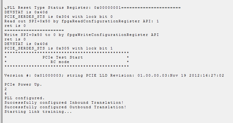

  • Gregor,

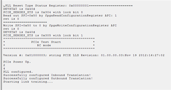

    Sorry for the delay, the issue to resolve is PCIE PLL lock. If It is not lock, the PCIE link can't up. I verified a different code in SPI boot mode and it worked:
    unsigned char value = 0, ret = 1;
    printf("======================\n");
    printf("DEVSTAT is 0x%x\n", DEVICE_REG32_R(0x2620020));
    printf("PCIE_SERDES_STS is 0x%x with lock bit %d \n", DEVICE_REG32_R(0x262015C), DEVICE_REG32_R(0x262015C)&0x1);
    printf("Read out SPI+0x50 by fpgaReadConfigurationRegister API: ");
    ret = fpgaReadConfigurationRegister(0x50, &value);
    printf("%d\n", value);
    printf("ret is %d\n", ret);
    printf("Write SPI+0x50 to 0 by fpgaWriteConfigurationRegister API");
    ret = fpgaWriteConfigurationRegister(0x50, 0);
    The printf is for debug purpose, the DEVSTAT should be 0x0000_040D all the times, with the setting of switches in SPI boot mode http://processors.wiki.ti.com/index.php/TMDSEVM6657L_EVM_Hardware_Setup
    "ret" should be "0" for success FPGA read/write operation. You should see read 0x50 return "1" at the first time, indicating PCIE expects a reference clock EXTERNALLY. After you calling the write API, with 0x50 to 0, you should see PCIE PLL lock (and read 0x50 returns 0).
    The read and write API code you can refer to   ti\pdk_C6657_1_1_2_6\packages\ti\platform\evmc6657l\platform_lib\src\evmc665x_fpga.c.
    One thing to note is for FPGA_MAX_ADDR_OFFSET, it is defined as 0x3F somehow, this preventing you operating at address 0x50. I changed it to 0x5F. Then the above APIs can read/write 0x50 address properly and when 0x50 is set to "0", I have PCIE PLL lock.
    Please let me know if this works for you or not. First, if PCIE PLL can lock in SPI boot mode, then can you have PCIE link up?
    Regards, Eric

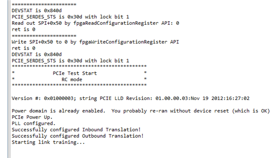

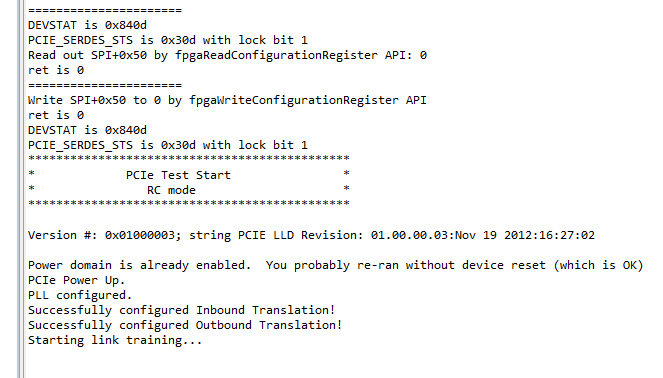

  • hi Eric,
    thank you for providing that code example.
    I set the switches in SPI boot mode as recommended and increased FPGA_MAX_ADDR_OFFSET to 0x5F and I get a PCIe PLL lock as you just described in your last post. This my protocol via UART during booting:
    One questions: When I run this code example via dubugger after booting the DSP via SPI (protocol of that is just above), I will get DEVSTAT = 0x840d and PCIE_SERDES_STS = 0x30d instead of the values in the picutre above.
    Are these two changes something you would expect? Is PCIE_SERDES_STS = 0x305 (during boot) ok?
    For your first question: Yes, now PCIe PLL can lock.
    For your second question: I cannot test now, as I destroyed the CLK_MUX (U1) on one EVM by causing a shortcut during checking with my scope. So now the CLK_MUX never provides some usable PCIE reference clock in all boot modes. I ordered a new module by IDT. When I can repair the board, I will let you know about the second question.
    Thanks, Regards, Gregor
  • Gregor,
    0x840D vs 0x40D, the extra setting bit means PCIESSMODE as PCIE RC, this is latched to SW5 PIN 7 AND 8 of 6657 EVM, I don't know how they are set. I assume you have the code flashed to SPI NOR and put DSP in SPI boot mode to run, after running the code, why you need to use CCS debugger to load and run the same code? Just a trial?
    For 0x305 for the PCIE_STS register, this should be fine.
    Regards, Eric

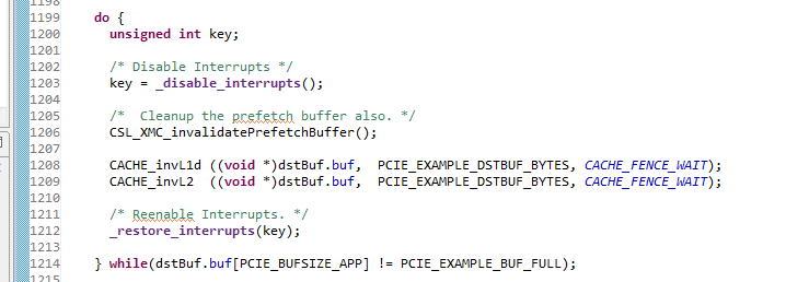

    Both DSP will never leave this section in pcie_sample.c: (for RC and EP respectively)
    Obviously that dstBuf.but never become full. That means, I see "Link is up", but nothing beyond.
    I just tried to boot Board A and B in "SPI" and checked the PCIE_SERDES_STS.
    I noticed, that PCIe_PLL is locked on both EVM, but register itself does not contain the same value.
    The board I had to repair is: PCIE_SERDES_STS = 0x30D, the other one: PCIE_SERDES_STS = 0x301.
    So the further one has a Lostdct and Sync for PCI0, the later one none of them.
    Could this cause my problem?

  • Gregor,
    The PCIE_SEREDS_STS doesn't look right when PLL is locked (but I want you to check this before PCIE test starts: one side is SPI boot, the other is no boot, for example, after PCIE link up, what is the PCIE_SEREDS_STS?, then wait for a few seconds, can you check again, if PCIE link still up and PCIE_SERDES_STS still ahs error)?
    When the PCIE code stuck, I am not sure it is because that SERDES status is not right (but you already pass the checking code and link up) or the PCIE SW has the problem. Let's rule out the PCIE SW first, this need you use CCS JTAG to check many memory locations:

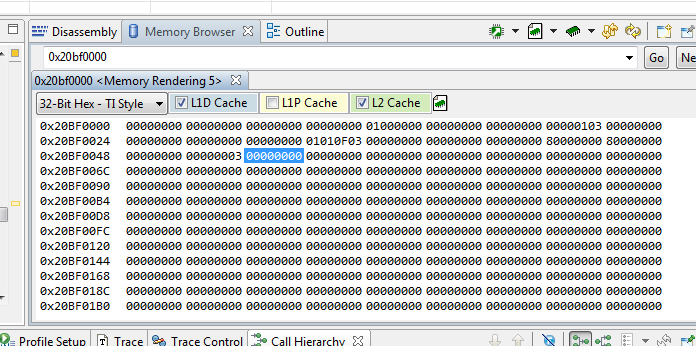

    - is the link up and stable @0x21801728 at both sides?
    - the RC writes a pattern to EP, did you see it at RC's memory 0x6000_0000?

  • hi Eric,
    thanks a lot for your comprehensive information.
    1) My configuration is: Board A boots via SPI the PCIe_example in RC mode (incl. your workaround). Board B is in no boot - already up, loaded the PCIe_example and waiting as EP for Board A to show up.
    2) Yes, I have the tested the PCIe_example after repair for both boards in no boot mode: it is working. But I also noticed that it is possible to get both boards (RC/EP does not matter) in the "Link is up"-state, even if the other board is still waiting at "main".
    I discovered following rule: I run one board with PCIe_example alone -> stop at "Starting link training". I stop that board and restart, but not running = waiting at main. I run the other board: It will stop at "Link is up.". If I restart, rerun that board again, it will hold already at "Starting link training."
    So I guess that the board will see some previous state of the other board and we cannot trust always in "Link is up".
    3) As references I read the register for "no boot - no boot". Same as your values.
    I did the same for "SPI - no boot" and I discovered some memory reading problems in the EVM I had to repair before. So I changed the roles (board A = repaired EVM, now in no boot, board B in SPI). I did that before with no success, but now: it was working - same results as no boot.
    I have no idea what changed compared to my last test. The link establishment is not always successful, even in no boot - no boot. maybe, I just was unlucky last time.
    Thanks + Regards.
    Gregor
  • now I know why it was not working so far:
    It is just successful the first time, when I PRO/reboot both sides before. If I try it again, both side stuck at "Link is up" but do not go further. Probably there is some bit set which prevents the PCIe_example to do the next step.
    This is probably the same issue as described in 2) above.
    I will sent you the word-doc in the problematic case later on.
    Gregor
  • Gregor,
    - Please push both EVM cards AMC edge securely into the break out card, if it is loose you will not get link up no matter what boot modes are.
    - In the PCIE test example, the PCIE module is turn on by pciePowerCfg(). I always power cycle both cards for a new run, so I avoided "remember the old status". If this is not feasible for you, you can add a similar code inside main to power off PCIE first and then power it on.
    void main() {
    pciePowerOffCfg(); ====> write a function to turn PCIE off and call here
      /* Power up PCIe Module */
      if ((retVal = pciePowerCfg()) != pcie_RET_OK) {
        System_printf ("PCIe Power Up failed (%d)\n", (int)retVal);
        exit(1);
    The code of power off should be just the reverse of what you did in Power it on, you may check PSC user guide for more details. http://www.ti.com/lit/ug/sprugv4b/sprugv4b.pdf. This can help you re-run the code without power cycle the cards.
    Regards, Eric
  • hi Eric,
    thanks a lot. That's the solution.
    With "PowerOffFunction" its working now in every run.
    Regards, Gregor
