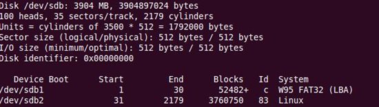

         2  I had filesystem on my Micro SD card.I make it EXT3 types. And I can mount it to Ubuntu ok.
    Do you have a filesystem on SD card's 2nd partition?
    Try this "setenv bootargs 'console=tty2,115200n8 noinitrd rw rootfstype=ext3 root=/dev/mmcblk0p2 rootwait mem=64M"
    What about the results?
    Are you facing same issue or different now?
    Please let me know the results.
  • Hi Titusrathinaraj:
        Thanks.
        Yes. I created 2 partitions on my SD card.
      What's wrong?

    From the attached logs,
    Have you formatted your SD card's 2nd partition as a ext2 ?
    Please ensure that you have enabled the "ext2" support in booted kernel.
