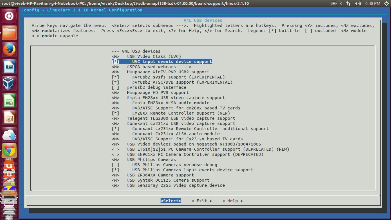

    1) After that enable UVC support using kernel menuconfig from the below thread
    2) Compile the kernel.
    3) Boot with latest kernel image then connect USB camera.
  • sir
    i have installed ncures successfully
    after that Linux/arm 3.1.10 Kernel Configuration opens
    in that i cant able to enable USB UVC support  <M>   USB Video Class (UVC)  when i am pressing Y to enable it gives a message i.e
    │ This feature depends on another which has been configured as a module. │
    │ As a result, this feature will be built as a module. │
    ├────────────────────────────────────────────────────────────────(100%)──┤
    │ < Exit > │
    what it means it gets enable or not  but after exit it remains as  <M>   USB Video Class (UVC)  M does't change to *
    does it enabled or what should be done ...
    when pressing y it gives
    1) Press "SPACE"  key for selecting UVC module and Enter then save it.
    2) Compile the kernel source
    make uImage ARCH=arm CROSS_COMPILE=arm-arago-linux-eabi-
    3) Copy the kernel image located at "arch/arm/boot/uImage" to SD card 1st partition.
  • sir
    after  pressing space it is not taking any value it remains M
    i pressed y but it same as previous says
    │ < Exit > │
    after that i press ? for help it comes like
    so i not getting it should be like <*> or < >or <M>  it does not get saved
    if i once again enter to it remains same as previous means it is not getting saved
    plz suggest
