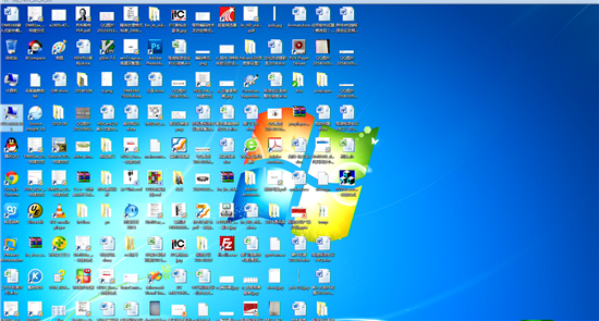

My env: dm8168 and dvr rdk 4.0
My chains: vcap->dei->sw->vdis.
My capture : use computer desktop signal.
we can be found the image quality not as good as the original (my capture desktop).
when I delete the DEI link. my chains:vcap->sw->vdis ,that the video quality is good as the original.
the capture desktop image(add DEI link):
the capture desktop image(delete DEI link):
 my question:
(1)   To add the DEI link may affect the image quality ?
(2)   if I must use DEI link (because I want to dynamically change the encode resolution), So, how can I fix the problem make the image quality better.
