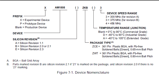

version details are
AM1808B ZWT chip here "B" denotes silicon revision 2.0 or 2.1

    In my case my AM1808 is v2.0 or v2.1 part number is AM1808BZWT  so we need to try both points. But 2nd point didn't work so there is only one choice we need to try 1st point.
    How did you confirm?

    My part number written in chip top view is
    AM1808B
    ZWT
    08ACS6W GI 456
        .  527  ZWT
    I hope here "B" denotes silicon revision is 2.0 or 2.1
    What I'm trying to ask is that how did you confirm/finalize the silicon rev is 2.0 instead 2.1 and why not 2.1?
    I also don't know how to confirm 2.1 or 2.0,
    Simply i asked, better to try 2nd option as you said,
