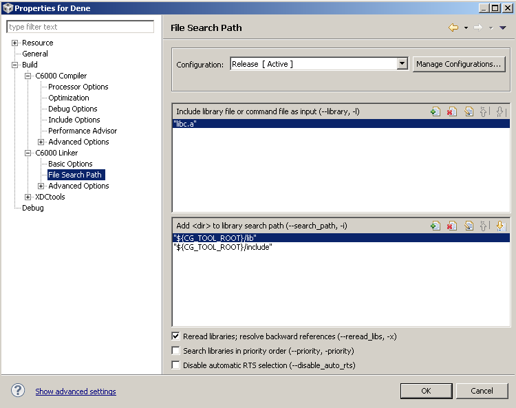

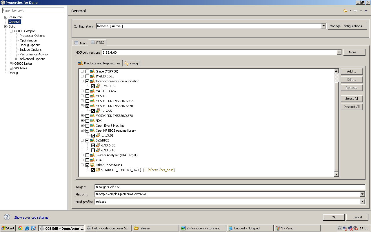

I have a problem about compiling Code Composer example OMP project for TMS320C6670 evaluation board.
My Code Composer Studio Version: 5.2.1.00018
Here are the screenshots, am I missing something in the configuration ?
Thanks in advance.
Hakan.

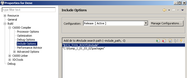

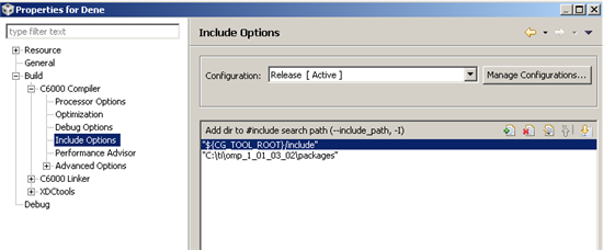

    I followed your procedure to build the project successfully. (Note: i did not add "C:\ti\omp_1_01_03_02\packages" in include path and "C:\ti\omp_1_01_03_02\packages\ti\omp\lib\release" in file search path. please delete this in your properties and try)

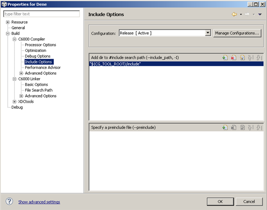

    I have removed "C:\ti\omp_1_01_03_02\packages" from include path and
    "C:\ti\omp_1_01_03_02\packages\ti\omp\lib\release" from file search path.
    But it can not find "omp.h".

    Apologize for the delay. I have change the compiler version in your project properties (TI v7.4.5) after change the compliler version i able to build your project successfully.
    Install the compiler version 7.4.5 and change the compiler in your project properties. i have attached screen shot in this threat.
