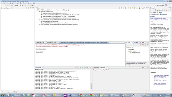

 I am trying to downgrade 6657 FPGA from v03 to v02. I get this error :
Can't find a source file at "D:\MY_TI_EVM\Gauss EVM\fpga_update_v03\evmc6657l\Debug/../main.c"
Screenshot attached.
Please advise.

  • Ivgeni,
    'Can't find a source file at "D:\MY_TI_EVM\Gauss EVM\fpga_update_v03\evmc6657l\Debug/../main.c""===========> this meant you don't have the source code for the FPGA update tool, since only the .out file was provided. You don't need the source code and this info is fine.
    You need to be very careful to follow the guide to update the FPGA. I believe the update failed somehow then the EVM is not operable (you can't connect JTAG emulator), please check with manufacturer (eInofchips) for repair service.
    Regards, Eric
