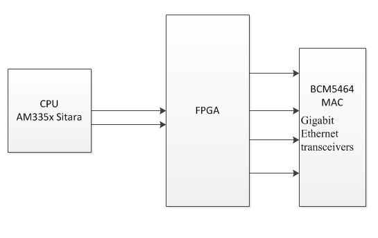

  • Hi Hay,
    for clarification you have the configuration represented in the image below and you are triying to manage the 4 PHYs connected to the BCOM chipset.
    Antony

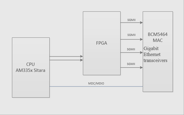

  • Hi Antony,
    I modified the diagram a little bit, see below.
    The FPGA is connected to the Broadcom phys via SGMII bus for data frame exchanges. We have this working already.  What we need is access to the management/control plane from CPU via MDIO bus.

  • Your description does seem to match the block diagram from a previous post.
    Here is what I understand from your last post.  The Micrel PHY is connected to one of the AM335x MII/RMII/RGMII ports. The FPGA has four SGMII ports connected to the Broadcom quad PHY.  The AM335x MDIO port is connected to all 5 PHYs.
    I'm still not sure if the other AM335x MII/RMII/RGMII port is connected to the FPGA. Your last reply seems to indicate the FPGA is not connected to the AM335x.
