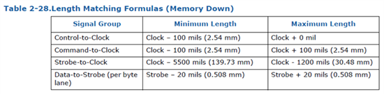

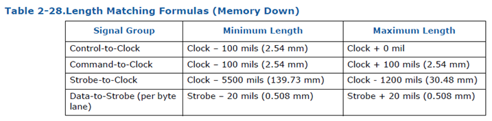

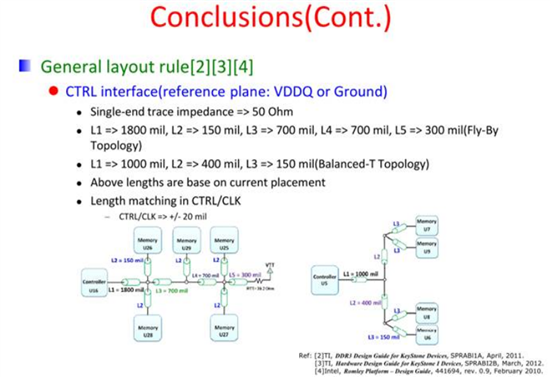

    about you question about 'Have you verified that your board meets the layout and length matching rules?"
    our HW say that length of DQ DQS CLK follow the table 2-28
    and the DDR layout use fly-by, you can see the below picture.
    about sw side, TI have supported emif and phy configuration for 1333MHz and 1600Mhz in UBOOT. I have check them for DDR spec and they are match.
    because we use the same DDR chip with EVM, so it should be fine.

  • Dear Aditya
    our HW support a file to you.
    Attached file is Keystone DDR3 length calculate spreadsheet based on DM81681’s form to modify.
    please check it.
    7065.DSP-XXXX DDR3_PCB_ConformanceV8.xls.
    thanks.
  • Hi Eager,
    The attached spreadsheet is not in the the form needed to determine whether the routing requirements are met. On the instructions page you have a diagram of the layout for the DDR3 memory structure. The fly-by routing of the address/command/clock signals must be length matched from the SOC to each of the memory components.  Your spreadsheet should include the following lengths for the address, command and clock signals.
    Memory 1, length of A1 + A2 + AS, Include the length of AS in a separate column since that has a separate requirement.
    Memory 2, length of A1 + A2 + A3 + AS, Include the length of AS in a separate column since that has a separate requirement.
    Memory 3, length of A1 + A2 + A3 + A4 + AS, Include the length of AS in a separate column since that has a separate requirement.
    Memory 4, length of A1 + A2 + A3 + A4 + A5 + AS, Include the length of AS in a separate column since that has a separate requirement.  Note that A5 is shown as A3 in the diagram.
    Even without the lengths in this form I can tell that the routing does not meet the published requirements. The address and command signals much be length matched relative to the clock with the following requirement.
    All nets in the address and command fly-by groups must be length-matched from the controller to each SDRAM separately within +/- 20 mils of the clock along the same route.
    The skew between the clock and the address/command for the first memory has a skew value of 388.51 mils. This is probably why the interface can't operate at 1600.
    Regards, Bill
