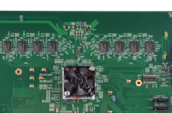

    The DM8168 EVM has 12V DC fan attached to the DM8168 processor for cooling:

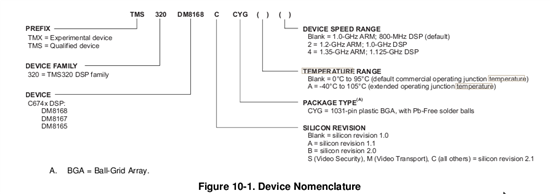

    Also, we have two types of DM816x devices:
    default - operating junction temperature range Tj is 0 to 95 C
    extended temperature - operating junction temperature range Tj is -40 to 105 C

  • We are using the same fan that's on the DM8168 EVM.
    We are currently using the 0 to 95 C version of the processor.
