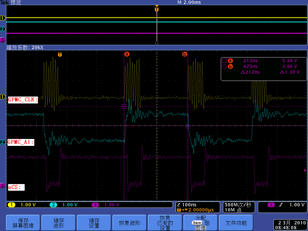

Hi all,
I try to find why delay between two successive read accesses is fixed at 180ns when GPMC clock at about 120 MHz and successive delay at gmpc GPMC_CONFIG6_i is set to 0.
The parameter setting for gpmc is bellow:

From figure, The time delay between a and b is fixed.
I want to reduce the delay. But even though I set the read cycle 3 clock, the gpmc clock nums is reduced according to my setting , the delay between is remain.
It seems that  the delay between is left for max burst word clock, so if you don't use burst. The delay is still left for no use.
Is there any suggestion for me?

  • Check out this thread:
    http://e2e.ti.com/support/dsp/omap_applications_processors/f/447/t/43106.aspx
    Short answer is to use DMA or at a minimum you might need to enable cache to that memory range.

    In view of caching, I don't think it's suitable for the device that I'm working on, as I'm not connecting an external memory device to GPMC, but rather an Ethernet switch; therefore, every read operation should physically retrieve the value from the device.
    Another thing that concerns me is that the Ethernet switch device does not support burst read/write. It only support asynchronous single read/write (ISA-like protocol). That's why the delay is really a huge concern. Will DMA solve this?
    I think so.  It should make a big difference.

    About the delay between 2 back-to-back asynchronous PIO reads, is this an inherent characteristic of GPMC? I'm just speculating here, but is there anyway to get around this without DMA?
    It is an issue inherent to pretty much every CPU.  When a CPU reads data it has to wait for that data to arrive before it can continue executing instructions.  So even if you have a bunch of read instructions in a row you will be stalled in between and that's my guess where the big delay comes from.  I made a comment about cache, because if cache was turned on the CPU would wait to get that one piece of data but the cache controller would pull in an entire cache line worth of data which would help the performance considerably.  The best option though is DMA.
