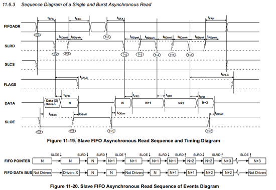

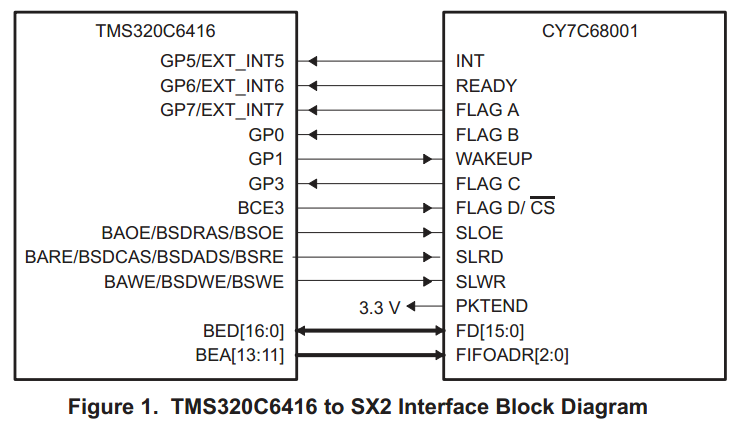

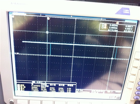

Hello,all;
In our prioject, use cy7c68001 chip connect to C6416 EMIB ce0. But the usb speed just only 300kbps~600kbps. The speed is too slow. Is anyone have an proposal to improve the speed. I change to use Synchronization type but the cy7c68001 command do not use. Thansk!!!!!

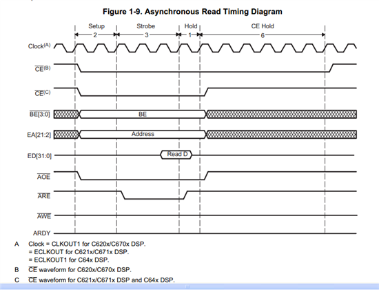

This is emifb configuration:
static EMIFB_Config MyEmifbConfig =
EMIFB_GBLCTL_RMK
EMIFB_GBLCTL_EK2RATE_FULLCLK, //one X EMIF input clock
EMIFB_GBLCTL_EK2HZ_CLK, //eclkout2 continue output during hold
EMIFB_GBLCTL_EK2EN_ENABLE, //eclkout2 enable output
EMIFB_GBLCTL_BRMODE_MRSTATUS, //bus request is memory access or refresh pending/in progress
EMIFB_GBLCTL_NOHOLD_ENABLE,
EMIFB_GBLCTL_EK1HZ_CLK, //eclkout1 continue output during hold
EMIFB_GBLCTL_EK1EN_ENABLE //eclkout1 enable output
0x22a28a22,
0x20a0c412,
0x22a28a22,
0x3373cd1f, // asynchronization 16bit type
EMIFB_SDCTL_DEFAULT,
EMIFB_SDTIM_DEFAULT,
EMIFB_SDEXT_DEFAULT,
0x00000002,
0x00000002,
0x00000043,
