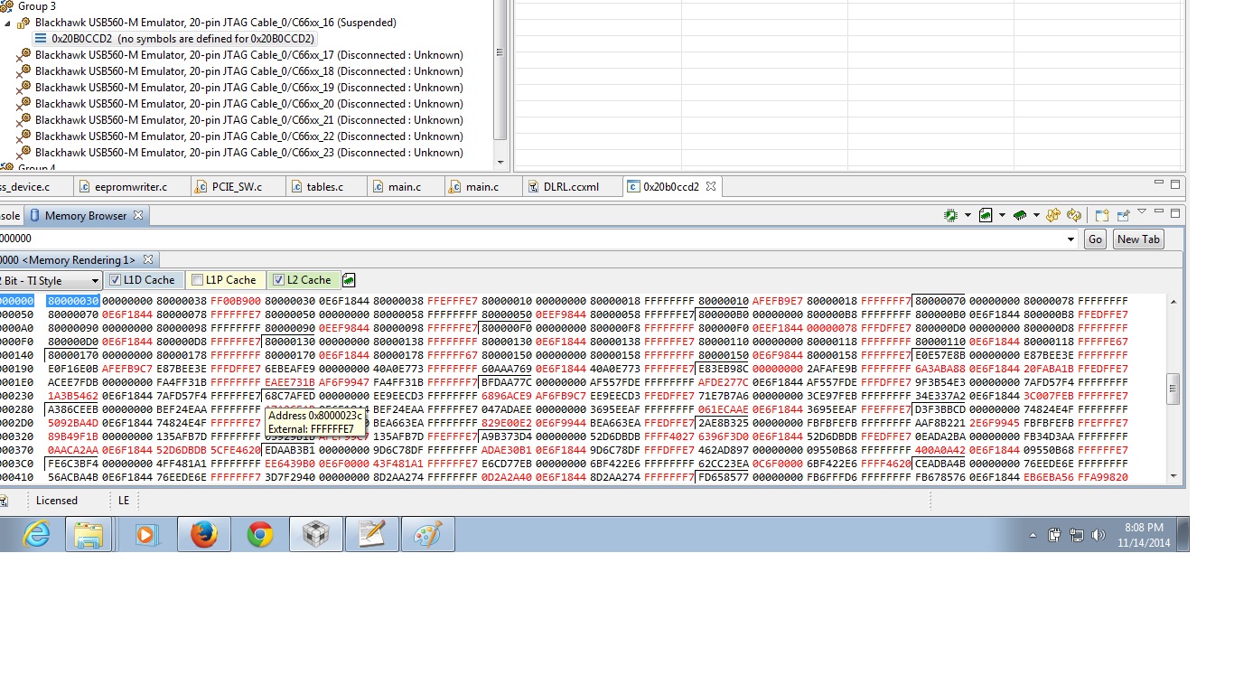

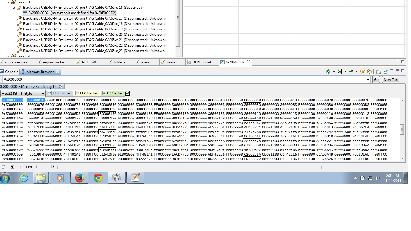

I Have also attached the Memory Browser screen shot before and after accessing the DDR3.
Before Acessing DDR3:
After Accessing DDR3:
