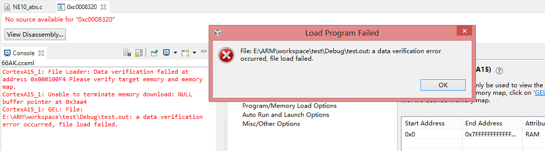

I want to debug ARM assembly on EVMK2H with ccs6, when I power on the board,then  connect to the first A15 core, and load the .out file to A15 core, but it failed because the .out file place the section of .text ,.data which  start  from  address 0x0, and the address 0 is not useable. Here is the pic:
How can I debug my arm assembly on A15 core? Can anyone help me ?

    It's my own code, I set the board as no boot, and load the program,it's the same error with before.
    In my arm project , I have no cmd file like the dsp project, and in the ARM project map, all the data and text section start from address 0x0,I have a doubt about whether I need add a cmd file for arm project, so that it can place the text and data section in a valid address range.

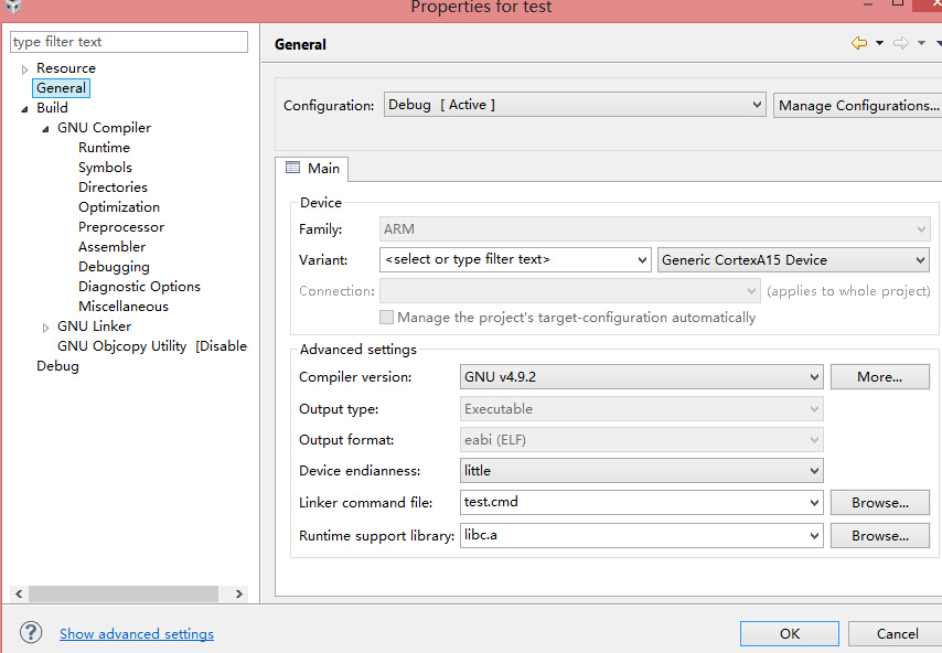

    I create a ccs project, do you create a ccs project or a c project? Here is my project  property:

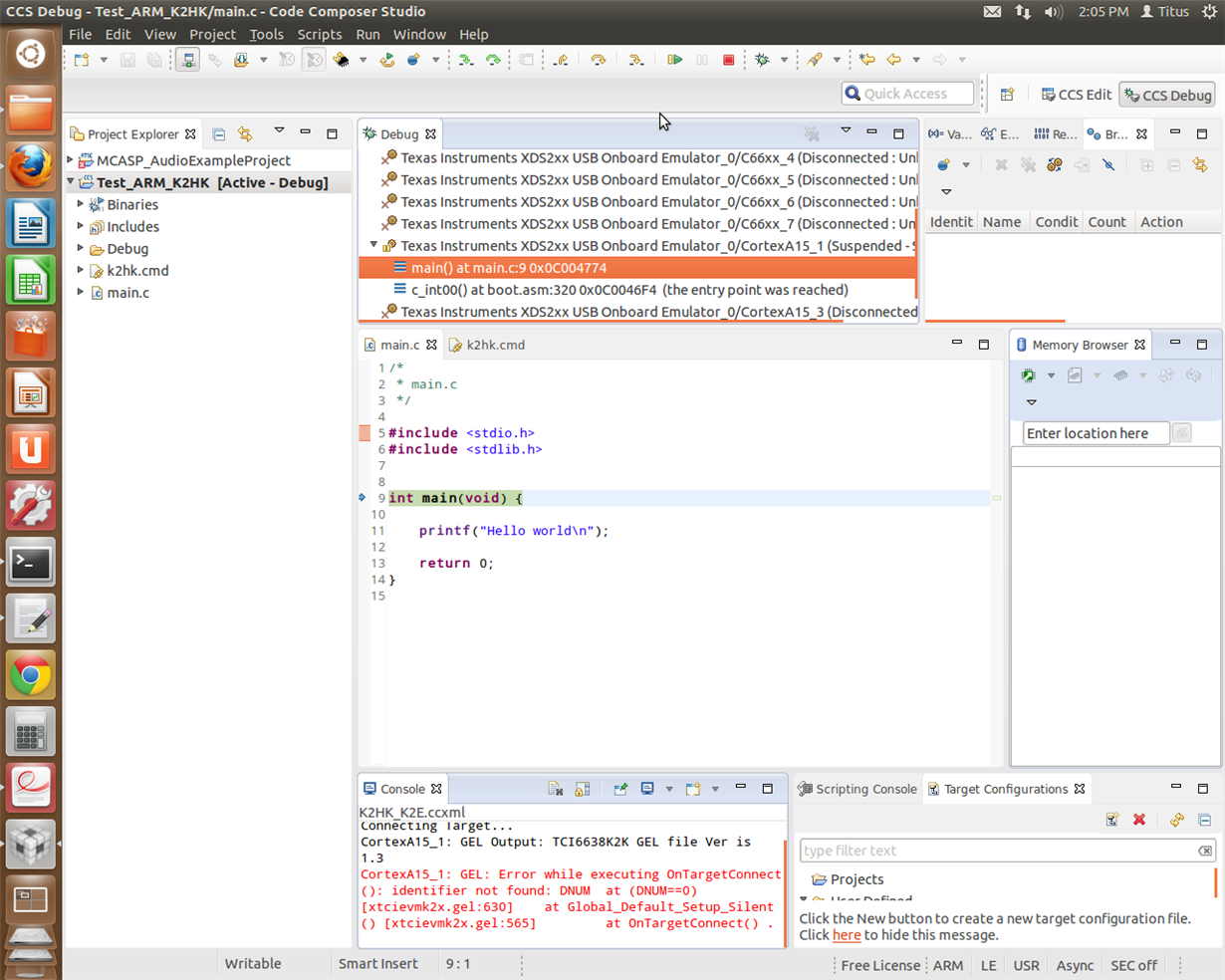

  • I've created CCS project for K2HK board on CCSv6 and not using generic Cortex A15.
    Also I have CCSv5.5 but I don't have a option for "Generic Cortex A15" to create a ARM project for K2HK board.
    What is your CCS version ?
    If not a CCSv6, could you try it on CCSv6.
    Else attach your project here (or send to me directly x0213399@ti.com)  I will try to build it on CCSv6 and let me update.

  • Who recommended to use this compiler ?
    Could you share the link where you got downloaded.
  • here is the link: www.linaro.org/downloads
    there are some introduction about the linaro cross compiler.
    Si
  • As you mentioned on the above post, I've tried to build with linaro (v4.9.4) toolchain and able to build but load failed like you and its not recognizing the .cmd file to map the correct RAM (DDR,IRAM etc.,)
    We have to use linker command file to map .out to RAM in CCS IDE.
    You need to use TI GNU ARM compiler to recognize the .cmd file while building.
