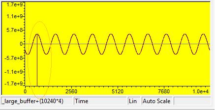

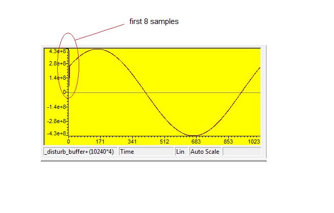

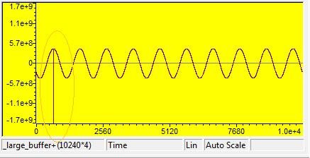

I set EDMA3 LLD 01_11_00_03 in order to transfer 8 McASP channels to SDRAM external memory using double (ping-pong) buffering. When acquisition is completed an EDMA3 chaining starts a transfer to sort samples in another 8 SDRAM buffers. And when final TCC is completed I immediately copy the final 8 buffers to another 8 ones for data integrity checking. Next there is a capture of one of the 8 buffers.
The same disturbance appears at the first 8 samples of 8 buffers in every acquisition. I guess this is due to some memory stall but I'm not sure. How could I check or debug this issue? Thanks in advance,

    • McASP receiver is fed by an external clock at 13,107200MHz. Assuming that 8-channel ADS1278 oversample by 256, McASP data rate is 51,2KHz
    • I see no difference between Release and Debug configuration
    • BIOS data, BIOS code, Compiler Sections and Buffer Manager are placed in IRAM
    • For capturing the glitch I calculate the difference of every sample with its prior value and check the threshold. I set a breakpoint to catch this condition.

  • By using the last McASP+EDMA3 configuration (with no chaining) I tried to set TC0 and TC1 priorities by changing MSTPRI register. I set EDMATC1=6 and EDMATC0=7 (assuming that McASP to SDRAM has the max priority and SDRAM to SDRAM data sorting a lower one) but unfortunately that made no difference. After some seconds I can see the glitches again in destination buffers...Read McASP FIFO enabling (RFIFOCTL.RNUMEVT=8 and RFIFOCTL.RNUMDMA=8) seems that does neither work.
    I really do not know how to solve the problem and think that may be similar to the thread started by Stephen, few days ago.
