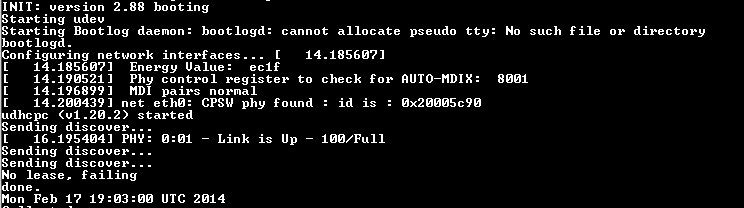

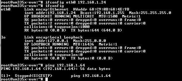

  • Dear Yordan,
    Thanks a lot for your replies w.r.t the above query,
    1. Now we are planning to use "DP83848" instead of Micrel fro our custom board, I did similar porting for DP83848 in u-boot ie.,, could you please let me know is there any thing needs to done w.r.t CPSW side, & could you please let me know id there anything else needs to be added inorder to get PHY up & running with DP83848 & could you please let me know does this enables AUTO-MDIX & speed at 100MBps??
    include/configs/am335x_evm.h
    #define CONFIG_PHY_NATSEMI
    drivers/net/phy/Natsemi.c
    /* NatSemi DP83848 */
    static int dp83848_config(struct phy_device *phydev)
    int mii_reg;
    u32 phyId;
    mii_reg = phy_read(phydev, MDIO_DEVAD_NONE, MII_PHYSID1);
    phyId = (mii_reg & 0xffff) << 16;
    mii_reg = phy_read(phydev, MDIO_DEVAD_NONE, MII_PHYSID2);
    phyId |= (mii_reg & 0xffff);
    printf("NatSemi DP83848 dp83848_config %s uid:%08X\n", phydev->drv->name, phydev->drv->uid);
    phy_write(phydev, MDIO_DEVAD_NONE, MII_BMCR, BMCR_RESET);
    genphy_config_aneg(phydev);
    return 0;
    static struct phy_driver DP83848_driver = {
    .name = "NatSemi DP83848",
    .uid = 0x20005C90,
    .mask = 0x3FFFFFF0,
    .features = PHY_BASIC_FEATURES,
    .config = &dp83848_config,
    .startup = &genphy_startup,
    .shutdown = &genphy_shutdown,
    2. Could you please let me know what are all the necesary changes that needs to be done in Device tree & kernel as well
    Kindly do the needful as early as possible,
    Awaiting for your replies,
    Many thanks in advance
  • Dear Yordan,
    Could you please provide any inputs w.r.t above DP83848 query
  • Hi Srini,
    No, I don't think you need to tune the cpsw side, the additions you've done regarding the DP83848 phy should be enough.
    Only check if the following code:
    #ifdef CONFIG_PHY_NATSEMI
    phy_natsemi_init();
    #endif
    is present in u-boot/drivers/net/phy/phy.c
    1. You need to add CONFIG_NATIONAL_PHY=y to your defconfig file.
    2. You need to add support for dp83848 in the current natsemi phy driver as you've done in u-boot.
    3. DTS configuration for cpsw is already done. You can check it & tune it according to your use case; see mac: ethernet@4a100000 dts node in am335x.dtsi AND  &mac, &davinci_mdio, &cpsw_emac0  and &cpsw_emac1 dts nodes in am335x-evmsk.dts (or whichever dts file you use).
    Hope this helps.
    Yordan

  • Hi Srini,
    Hope all is well. I'm currently having problem with the kernel and wonder if you got your working. The kernel was able to detect the PHY but I'm not able to ping to any any local network devices.
    Which version of the kernel are you using? I'm using 3.2 from the TI SDK 6.0.
    I switched out the /drivers/net/phy/national.c to the national.c file you attached in previous post.
    kernel boot log:
  • Am using ti sdk 8, kernel 3.14 version,
    ifconfig eth0 192.168.1.24 netmask 255.255.255.0 up
    Outside network should be same class
    1. try dhcp..
    2. try configuring static ip during bootup time /etc/network/interfaces (google it)
    Srini
  • Dear Khanh,
    Is this issue is fixed??? Have you got it working with static ip configuration, using the driver (national.c) in your kernel??
    Srini
  • Hey Srini,
    Unfortunately, I still wasn't able to do any ping even with static ip configuration. Since I'm using RMII mode for my PHY, I also added this line in dp83848_phy_config_init():    phy_write(phydev, DP83848_RBR, 0x0031), to enabled RMII mode.

    static int dp83848_phy_config_init(struct phy_device *phydev)
    	int val = phy_read(phydev, DP83848_EDCR);
    	int value,data;
    	if (val < 0)
    		return val;
    	phy_write(phydev, DP83848_BMCR, 0x8000);
    	value=phy_read(phydev, DP83848_BMCR);
    	printk("\n BMCR: %x", value);
    	/* Enable RMII mode */
    	phy_write(phydev, DP83848_RBR, 0x0031);
    	value=phy_read(phydev, DP83848_RBR);
    	printk("\n RBR: %x", value);
    	/* Auto-Negotiation */
    	phy_write(phydev, DP83848_ANAR, 0x01F1);
    	value=phy_read(phydev, DP83848_ANAR);
    	printk("\n ANAR: %x", value);
    	/* Enable energy detect control */
            value = phy_write(phydev, DP83848_EDCR, DP83848_energy_detect_en);
          	value=phy_read(phydev, DP83848_EDCR);
    	printk("\n Energy Value: %x", value);
    	/* Enabling interrupts */
    	// phy_write(phydev, DP83848_MICR, 0x0003);
    	// value=phy_read(phydev, DP83848_MICR);
    	// printk("\n MICR: %x", value);
    	// value=phy_read(phydev, DP83848_MISR);
    	// printk("\n MISR: %x", value);
    	value=phy_read(phydev, DP83848_PHYCR);
    	printk("\n Phy control register to check for AUTO-MDIX: %x", value);
           	value=phy_read(phydev, DP83848_PHYSTS);
           	printk("\n PHYSTS 0x%x", value);
    	data=value & 0x4000;
    	if(data>0)
    	printk("\n MDI pairs swapped\n");
    	else
    	printk("\n MDI pairs normal\n");
    	return dp83848_phy_ack_interrupt(phydev);

  • Where u able to ping with dhcp?? Even I haven't tried with static ip, will try & let you know.., but its working for me with dhcp
  • I know the PHY works in U-Boot because I use TFTP to load the kernel onto the ram. I used dhcp in U-boot and it works flawless. I also tried dhcp on the kernel but it wasn't able to ping. Thanks for helping
  • If possible, can I get your .config file? See what if I'm missing something in mine.
  • Just to reconfirm does dhcp works in u-boot, hope kernel gets loaded to ram without any issues??? have u ever tried loading NFS (Network file system)? via dhcp??
    When am back to office on monday, will send you the config file
  • Yup dhcp works in u-boot and the kernel got loaded to the ram without any problem. The kernel boots fine also, but when I try to dhcp from the kernel, it wasn't able to get anything.  I haven't try loading NFS yet. Load it during u-boot along with the zImage?
  • Yes...
