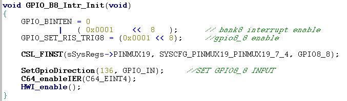

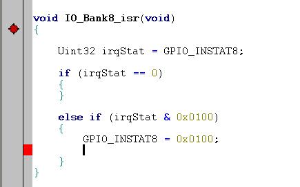

I want to use GPIO bank interrupt.
this is bank8 pin8 interrupt init function.
and this is bank interrupt block.
I connect function generator(1Hz square signal) to GPIO8_8 pin. and compile -> program -> run....
program doesn't go to "IO_Bank8_isr"..
give me some advice.

Could you attach the complete code that you are using , or using the example code without modifying anything ?
Try to debug the code, check the GPIO register (interrupt enable) through register window that you written.

I use custom board. I note that LogicPD EVM.
this is test source i'm using.
