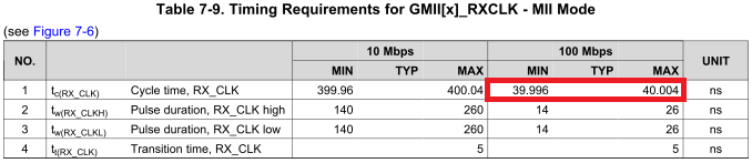

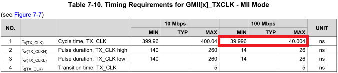

In timing requirements on datasheet (SPRS717H) the 100Mbps cycle time of RX_CLK and TX_CLK is 39.996ns to 40.004ns.
It seems very difficult to meet this correctly. If not met, what occurs? Can the packet loss occur? Is it possible that the link in 100Mbps mode does not establish?
MII signal functional specifications in IEEE802.3 Clause22 describe "The TX_CLK frequency shall be 25% of the nominal transmit data rate ± 100 ppm". I guess that the cycle time of datasheet is the value estimated based on this. Is my guess correct?
