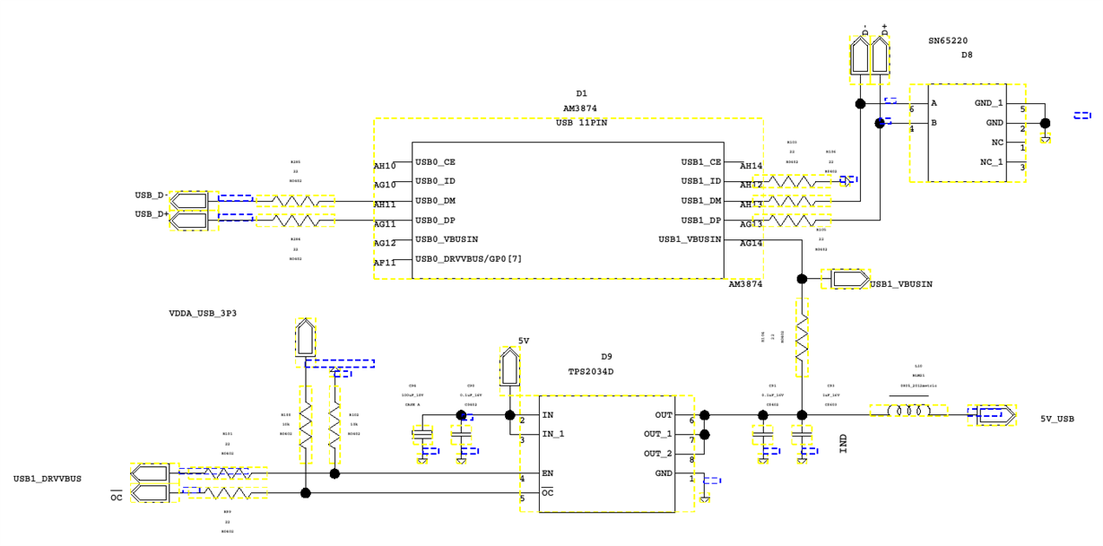

I'm trying to configure USB1 controller on our AM3874 based device in host mode.
As recommended in TRM we use USB1_DRVVBUS to control external power source. According to TRM "The control on the USB_DRVVBUS is automatic and is handled by the USB controller. The control should be transparent to the user so long as the proper hardware connection and software initialization are in place."
So, kernel (ti-ezsdk_dm814x-evm_5_04_00_11) is configured according to .
PINCNTL14 register (for L5 pin) is configured for USB1_DRVVBUS mode.
I can see that TI81XX usb platform glue layer in ti81xx_musb_set_mode() function sets USB1MODE register to 0x0, that matches host mode.
However USB1_DEVCTL register value is 0x80, that doesn't match host mode and also USB1_DRVVBUS pin (L5) is not driven high, hence, no power is supplied from external source.

In attachment there is also a partial schematics of our USB circuit. USB0 is not in use, we are interested only in USB1.
What do we do wrong?

    Looks to me like HW design issue, as the same configuration is working on the TI EVM board. You can check the TI EVM schematics, AM387x datasheet (section USB) and below wiki page:

    I compared our schematics with a reference design of TI EVM and didn't find significant differences in USB1 circuitry.
    We also have X-ray images of our board, so I could check USB1_ID pin soldering and it looks to be ok. According to TRM and USB drivers this pin serves as the only condition for USB controller to decide about its mode and to drive USB1_DRVVBUS pin high/low.
    So we have USB1_ID pulled down, but USB1_DRVVBUS is not driven high.
    Its clear that I'm missing something but I can't understand what is it.
    Anatoly
