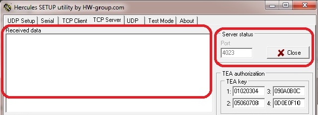

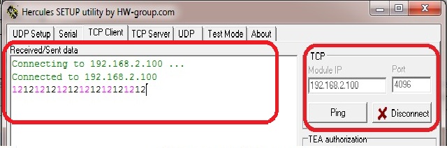

    I ran "C:\ti\mcsdk_2_01_02_06\examples\ndk\client\evmc6678l" but it didn't work as a client. I explain the test procedure:
    board: evmc6678l
    CCS: 5.3
    MCSDK: 2_01_02_06
    at first I set the PC IP address in "client.c" file as below:
    after that I set the port number of DSP when it works as a server "4096" and as a client "4023", as below:
    but when my test software starts the communication, The DSP(server) works correct as following:
    but when my test software is listening, the DSP dosn't start the communication(client) as below:
    What is the problem? How can I solve it? Does it have any relation to the situation of jumper or deep switches on board?

    In project "C:\Program Files (x86)\Texas instruments\mcsdk_2_01_02_06\examples\ndk\client" the "client.c" file that I attached is consist of "StackTest" function. I assumed that in lines 333 up to 335 I should set the IP address of destination device (PC, FPGA...). Is what i did wrong, According to my assumption that I Set the IP address of destination device in that lines?
    after that in the function "NetworkOpen" in first "DaemonNew" I set the port of DSP (I assumed DSP is server in TCP connection) 4096.
    In the last "DaemonNew" I set the port of DSP (I assumed DSP is client in TCP connection) 4023.
    For understanding what functions "dtask_tcp_echo" and "dtask_tcp_oobsrv" do, I found the "newservers.c" file and added it to the original project.
    The function "dtask_tcp_oobsrv" didn't run!! Why??
    The "printf" direction in "client.c" at lines 476 and 479 never printed even I open the network cable!!! Why?
    We can run the NDK client example in two ways, either DHCP mode (gets IP automatically from DHCP server) or Static IP mode (you have to set up manually).
    We can select this IP mode in DIP switch settings (SW9), you no need to change any code like lines 333 up to 335.
    Please refer to the following C6678 hw setup TI wiki page.
    processors.wiki.ti.com/.../TMDXEVM6678L_EVM_Hardware_Setup
    Use "System_printf()" API instead "printf()" API.
    To enable "printf()", you have to declare "#include <stdio.h>" line in project.
    Its server for TCP OOB.
