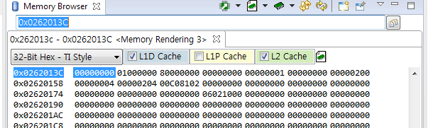

When I read the BOOTCMPLETE(0x0262013C) register, it shows all zero as following screen shot.
I have read almost threads related with BOOTCOMPLETE including you indicated.
The threads are saying only hardware can pull high the BOOTCOMPLETE, right? But I couldn't find anything wrong in my board.

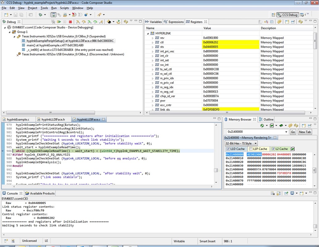

1. After resuming the core (click resume button), the status of the core changed from "suspend" to "running" and I could access memory addresses without error messages. Is my method correct?

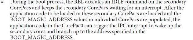

2. I though RBL booting can be completed without IBL and application code. But I found the condition of setting BOOTCOMPLETE register is all corepac gets BOOT_MAGIC_ADDRESS and the corepac can get the BOOT_MAGIC_ADDRESS by application code. It means BOOTCOMPLETE will not be high without application code. Am I correct?
I found these from
https://e2e.ti.com/support/dsp/c6000_multi-core_dsps/f/639/p/162509/653246#653246
sprugy5c document

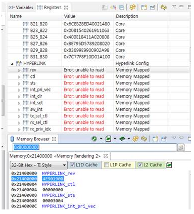

3. By the way, when I access (memory mapped) register, there are still errors while core registers look fine. At that time, "view memory at address" menu shows the register in the memory browser. Please refer to following screen shot. Would you let me know what I need to know to see registers in the register view?
